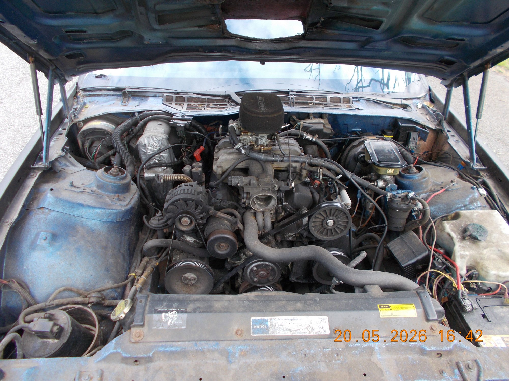

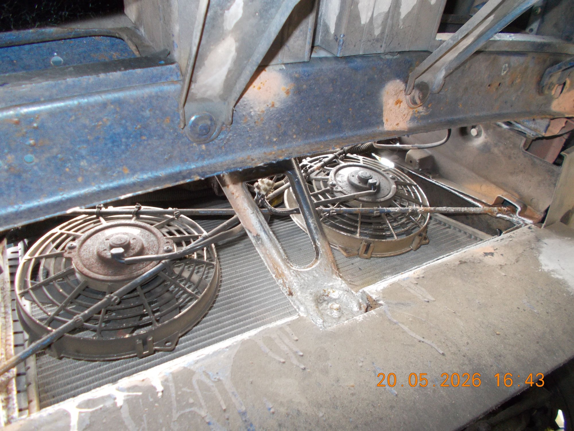

for context the most we both know is how to check & top up the fluid levels. I can change bulbs & fuses though. I`ve never really done any vehicle maintenance myself, the previous owner last year did supervise me changing a front wing on our other vehicle, but had to talk me through how to do it & come & check. Though he was dying at the time, we just didn`t know it then. We really want to keep the car in his memory & make use of it, if we could get it resprayed we would like to take it to local shows too.

Re: 91 rs overheating.
I hate to be that guy, but from the pictures I'd say a little steam is the least of your concerns. Somebody correct me if I'm wrong but that appears to be a carburetor bolted to the top of the fuel injected intake manifold. There also appear to be three extension cords hanging by the fans that look like they are probably connected the headlights. I honestly don't know where to begin with something like this.

I'm surprised the car didn't catch fire and burn the previous owner alive. Don't ever get in this car again and start or drive it unless you want to join him in the afterlife.

This can't be for real right?
Just an old long time member with a new account "taking the **** out of us"?
These pictures are all just AI right?

I just about burst into laughter when I saw the pics.
But seriously, its definitely the head gasket.

I blame Richard Holdener for this. He put a Holley 4 barrel carburetor on top of the plenum of a Tuned Port Injection engine.
I couldn`t say to be honest.
I know the previous owner was a bit of a mad scientist/evil genius type person, but in a good way.

This car is a Death Trap that will maim or kill you or someone you love.
Push it out into the yard and use it as lawn art. A conversation starter maybe.
Don't ever start it or drive it again.
The only person that understands what is going on under that hood is gone now. No one here on this forum in their right mind can help you with this car.

Idk what's more impressive, the fact that the motor even starts and runs like that or OP has taken it on *multiple* almost hour long trips.
Anyway, it's overheating because the fans are on the wrong side of the radiator.

Holy smokes Batman, I was NOT expecting to see a carb bolted to the top of a 3.1 like that
honestly kind of impressive that it even runs. I think someone on this forum did something similar (or at least tried to) using an Eaton M90 supercharger bolted to the top of their V6 intake like that, but.... wow. I know you mentioned that you weren't really good with vehicle repairs, so I'm wishing you the best of luck, that thing looks like an absolute cobbled nightmare. Ignoring everything not related to the cooling system for the time being, I do also see that the coolant overflow tank appears to have been ripped out, which could be an issue. If you look next to the radiator cap, you'll see that little hose sticking out. Basically, when your cooling system starts to get hot, the pressure pushes the spring on the radiator cap up, and coolant comes out of that barb. From factory, that line ran to a tank on the pass side fender (mirrors the washer fluid tank), and that's where the coolant would go. As the car cools down, fluid gets sucked from that tank back into the radiator. I don't think that would cause all of your overheating issues, but if that line isn't running to any kind of container, then your fluid may just be dumping out on the ground when it gets hot.
As exiled350 mentioned as well, the fans MAY be on the wrong side of the rad. From factory, the 3.1 would have one big 16" fan mounted on the engine side of the radiator, instead of 2 fans on the bumper side. Now, they DO make pusher fans, which WOULD bolt to the bumper side of the rad, but you'd have to look at the direction of the fan blades to see if the guy put the right kind of fans on. If those are puller style fans, then they're doing absolutely nothing for you mounted on the bumper side. THOUGH, in a 3.1, the fan shouldn't be kicking on at all while the car is moving anyways. In a well functioning 3.1, the air that gets forced through the rad is more than enough to keep it cool while on the move, and the fan only kicks on when you're sitting in traffic. If those are puller fans though, and if they're wired to run off a toggle switch or something, they'd probably be creating some kinda negative pressure situation that prevents air from moving through the rad effectively while on the move. If you can switch the fans off, try to keep them off while you're moving, it may help.
EDIT: Looking at the direction of the fan blades on your fans, those do actually appear to be pusher fans, so those may not be your issue. Total shot in the dark here, but I wonder if the car is running too lean.... usually when someone goes and bolts a carb to the top of their FI intake like that, the original throttle body (where the air comes in the front) is blocked off. It looks like your motor is pulling air through the carb AND the original throttle body..... the fact that this thing runs really is a testament to the tenacity of the 60degV6
very possible that it's getting too much air, not enough fuel.

honestly kind of impressive that it even runs. I think someone on this forum did something similar (or at least tried to) using an Eaton M90 supercharger bolted to the top of their V6 intake like that, but.... wow. I know you mentioned that you weren't really good with vehicle repairs, so I'm wishing you the best of luck, that thing looks like an absolute cobbled nightmare. Ignoring everything not related to the cooling system for the time being, I do also see that the coolant overflow tank appears to have been ripped out, which could be an issue. If you look next to the radiator cap, you'll see that little hose sticking out. Basically, when your cooling system starts to get hot, the pressure pushes the spring on the radiator cap up, and coolant comes out of that barb. From factory, that line ran to a tank on the pass side fender (mirrors the washer fluid tank), and that's where the coolant would go. As the car cools down, fluid gets sucked from that tank back into the radiator. I don't think that would cause all of your overheating issues, but if that line isn't running to any kind of container, then your fluid may just be dumping out on the ground when it gets hot.As exiled350 mentioned as well, the fans MAY be on the wrong side of the rad. From factory, the 3.1 would have one big 16" fan mounted on the engine side of the radiator, instead of 2 fans on the bumper side. Now, they DO make pusher fans, which WOULD bolt to the bumper side of the rad, but you'd have to look at the direction of the fan blades to see if the guy put the right kind of fans on. If those are puller style fans, then they're doing absolutely nothing for you mounted on the bumper side. THOUGH, in a 3.1, the fan shouldn't be kicking on at all while the car is moving anyways. In a well functioning 3.1, the air that gets forced through the rad is more than enough to keep it cool while on the move, and the fan only kicks on when you're sitting in traffic. If those are puller fans though, and if they're wired to run off a toggle switch or something, they'd probably be creating some kinda negative pressure situation that prevents air from moving through the rad effectively while on the move. If you can switch the fans off, try to keep them off while you're moving, it may help.

Definitely didn't have this on my WTF bingo card. Aside from all that has been mentioned, there looks to be some significant rust on the driver's side near the firewall. That's a sign of potential significant rust on other areas of the vehicle.

OP: You don't have the tools/skills or knowledge to fix this car and all of it's (many) issues. I think that you need to re-assess your ownership of this liability.

Thank you for the pictures.
There is no way you, nor I, could have described that with words.
Now where you go from here is going to be a bit of a fun trip.
Are you ready for a V8 swap?
Might be the best route to take is to remove the current drive train and 'start over'..

Carb bodged onto MPI 3.1 is just too cute
and the original throttle body needs to be sealed off all the way so there is no vacume seepage. The two small fans zip-tied to the cross braces are too far from the radiator to cool very well. Looks like O.P. might be over in central Europe, Russia, Ukraine, etc, so lets help him out
