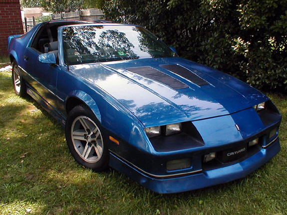

like these...

IROCs were 85-90 , that hood did come on IROCs and Zs after '84 I think, not sure when Zs started gettin that hood.

so it's a special hood? the loovers will not fit in the indention on my 84?

No,the louvers are too wide for the 82-84Z28 hood.The IROC hood does have indentions in it with 1/4"holes in it for the pegs,that are attached to the louvers bottom, to fit through and bolt on.Actually the IROC hood came on the 85-87 Z28,85-90 IROC and the 91-92 Z28 which have blisters intead of louvers.
