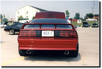

Hey I'm interested in doing this taillight mod to my car and I was wondering how you do it?

VHT metal tint.
Take the taillight apart, tape off what you don't want painted and then put on several thin coats. I am going to do this when I get a different set of taillights. I am not sure of drying time. Use yahoo or something and search for VHT the website will be right there.
Hope that helped. If I got something wrong someone speak up and help him out eh.

I belive some people have used model car paint. Testor's has a Transparent Candy Red Metallic that should do the trick. Check your local hobby shop.

Yeah, Testors Candy Apple Red is commonly used I believe. Try a search, it will provide plenty of info on it.
Who's car is that in that picture? It looks sweet.

i have that picture saved on my computer....i will one day be doing that to my car in the future......that picture is a photochop tho....u can tell by the amber reflection in the bumper
Good eye... and also the real red part and the part thats usually amber is exactly the same

ok so what exactly was done to that car??? im confused.
Old Jan 19, 2003 | 08:48 AM
'89 IROC Vert's Avatar
Posts: 358
From: Houston, Texas
...no orange turn signal.

oh yeah i had a question with the testors paint....do u paint the inside or the outside of the lense?

For best results paint the inside of the taillight cover. I know I build models all the time. I have used the paint in question before.

i want to see what a finished product looks like before i go and try this. nice photoshop BTW.

how wide are those tires??
Old Feb 8, 2003 | 01:58 AM
TBones87's Avatar
Posts: 53
From: KCMO
Car: 87 Camaro LT.
Engine: 305 LG4
They look like 255's or 275's...i guess they could be 295's but i doubt it.

i dunno, not my car....sorry

Pait the inside for best results.
as for the tries. Ive chatted with that guy befor. via e-mail long time ago.
Those are 17x11 Zr1 rims with 315's out back.
I'll have to look through all the pic's I have and find the other ones he e-mailed me also.

when you do this, do you have to remove the old amber color or does it stay on what do you exatly do cauze i have been thinking of ways to do this but can't come up with any

One of the most important things when you do this is to REALLY clean the inside of the light that you are painting.Use thin coats and let dry in between coats.I used the VHT metallic red and make sure where your painting is warm that paint doesnt like cold weather......

that picture is actually a photochop

All tailights come apart...they are just not really made to. Mine (firebird) had clips that want to break when you take them apart. They also had some type of black really sticky soft glue like Butyl tape. It came apart and the glue was all sticky and stringy and remined my of hot cheese on a pizza, but when back together fine. It took me and evening after work to do mine.
The testors or VHT debate is simply preferance. I tried both and the testors compared to the VHT metal tint was cloudier. The VHT dried with a more clear transpartent look closer to that of the original lens.
With the VHT it is a transparent paint, so if you wanted to spray it on the inside and the Niteshades on the outside, no it would not cause the red section to be any darker then the original red lenses. You are basically tinting with a transparent color. Light still comes thru at the same rate, unless you spray on too much!
Again it is best to hold the light up and test its light transmition color compared to the stock red.
Stock
my car...
After painting the red...the amber hue is due to the camera flash
Here is a night pic with the lights on and the flashers on so you can see the color of them...
on the car in the day...[IMG]
here you can see how when the sun is on the lights there is a bit of a amber cast, but noting like stock!
http://images.cardomain.com/member_i...1_236_full.jpg[/IMG]
