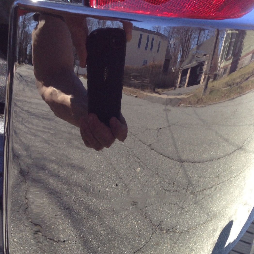

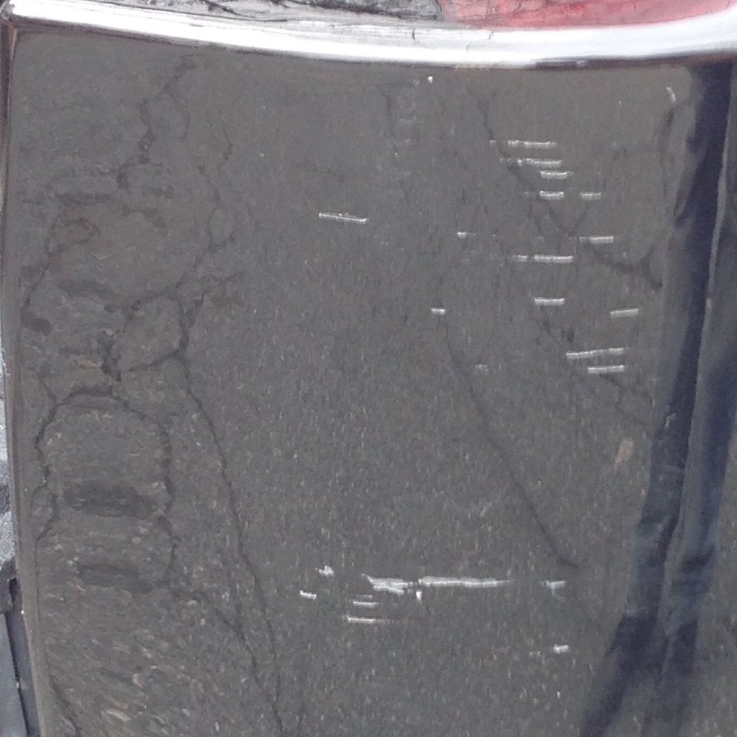

Someone bumped my Tahoe bumper in the city (people that can’t parallel park!). Drove me mental..
