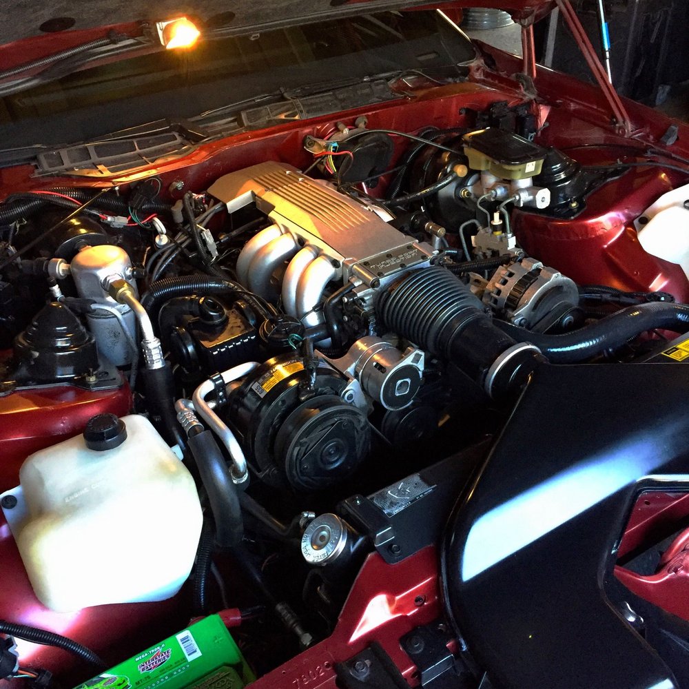

Anyone ever open their hood to find their hood insulation ripped down into a nest on top of their valve cover and filled with little football shaped excrement..
Well I did..
Within a week I detailed my engine which needed it anyway..
-covered the battery, alternator and distributor with plastic bags
-used simple green sprayed on engine components and used small brushes to disturb grime
-sprayed more simple green and let sit for a few minutes
-rinsed and dried engine with paper towels and shop vac for crevices
-used soap solution and sponge for painted surfaces
-quick detailer and terry cloth on painted surfaces
-Tire foam on plastic and rubber.. let sit over night and did final wipe down and inspection.. (had tire foam on my last thirdgen for 10 years and never had an issue with anything..It cleans and drips gunk to the ground which is nice..other products are just for shine)
I got a new hood liner from 1A Auto and it looks better than the dusty old original one did..
How mortifying that was!
We have a small horse farm so we have critters.. need more work on the garage clearly!

Wow! You sir are an inspiration, an engine detail is at the top of the list on my recently purchased IROC.

That looks so clean, just a fantastic job well done!!

Looks so damn good you make me want to go try to polish my lil turd of an engine.

very nice indeed!

Those pics of the engine look AMAZING!!! Nice work

I looked at the picture you posted and thought I would help out so I went ahead and circled all the areas that needed refinished and use arrows to point out the spots you forgot to clean. Good luck.

Looks great!

Thanks guys! Ha ha... make those arrows bigger there Tibo I missed them!
