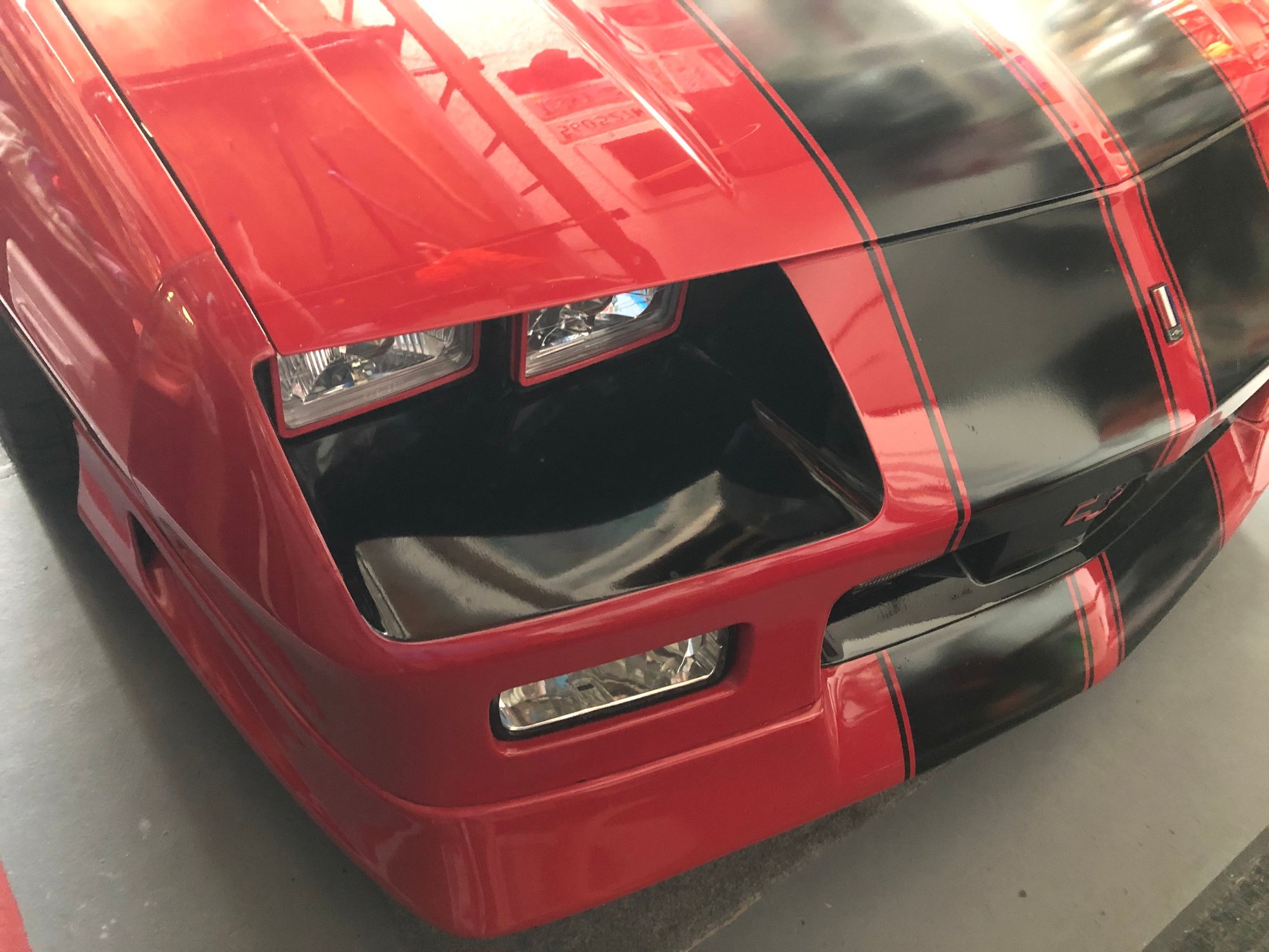

1987 IROC-Z done in Avery Cardinal Red and is going through a resto. Interior completely redone. Still waiting on the dashpad. This is my 3rd 3rdgen that I've wrapped and idk why I keep putting myself through this torture. I guess it's because the end result is satisfying. The black 91 Z28 was done in Vivvid Vinyl black satin aluminum a few years back. The extinct 92 RS (which i owned for 24 years) was done in 3m satin black.

They all look great, especially the Z28. What's the benefit to a wrap compared to paint? how long does a wrap last?

Thanks, cost is the benefit if you do it yourself. Wrap jobs last just about as long as a regular paint job 5-7 years. Another benefit is if you scratch it just peel it off that section and lay down another piece. Prep work is exactly the same as a regular paint job. Smooth surface smooth results

I really like the Z-28! Looks great. It's nice that you can replace a piece if it gets scratched. How difficult is it to remove? Heat gun, and then just peel?
Kind of off-topic, but what wheels are those? Size, offset, tire size? Did you need adaptors/spacers to make them fit? Thank you.

Yes you use a heat gun and just peel it off. The wheels are XXR 531 18x9 front 38mm bs with 1"spacer 265/40 and rear are 18x11 305/35. Wheels have been redrilled by a local company to match bolt patterns.

Turned out really good, Dennis. She gotta be loving it so far. Can't wait to see it in person.

If you don't mind, how much did it cost in materials to complete the car with the wrap?

A 45ft roll costs between $300-$400 dollars depending on the manufacturer. Probably more for the style of vinyl. Then about $30 for a wrap kit that includes squeegees, gloves, blades, etc. to get you started.

Wow. Looks good. I wonder what black would look like compared to paint...

it's not gonna look super smooth and glossy like a high dollar paint job up close but from far away you wont be able to tell the difference. i've had people compliment me on the awesome paint job on the Iroc and then they're shocked when i tell them its not paint if that says anything.

They look real nice I got a couple questions from a fellow wrapper who has considered this.
Were you able to do the front and rear plastic in 1 piece? were you able to keep the material from lifting in those channels on the rear bumper cover? Primer 92? Did you wrap the mirrors? Did you have to do inset pieces on those air scoops in the GFX? If you did do some sections in pieces, I assume you did the headlight buckets separate, if so did you use knifeless tape to do the cuts?
It came out really nice but from the photos you won't be able to see the seems so just curious on how you got the vinyl to work around those problematic areas. I am familiar to hiding the seems on transition areas.

I tried to do the front and rear in one piece but it was almost impossible without overstretching and discoloring/distorting the vinyl. The channels in the rear bumper cover were done first as an inlay then the rear was done in 4 pieces since the curves were complex.Mirrors were wrapped in 3 pieces - top, bottom, and the inside facing the window. All cuts were made using knifeless tape. I didnt use insets on the side gfx of the 91 but i did use a satin inset on the front gfx to give it some contrast. Before wrapping them i spray painted black the openings of the gfx so you couldnt see the actual body color. The front headlight buckets were done separate and cut with knifeless tape. Front nose was done in 2 pieces with the overlap cut in the center where the emblem is. To keep all the edges from lifting up later on you have the heat it before making the cut.
