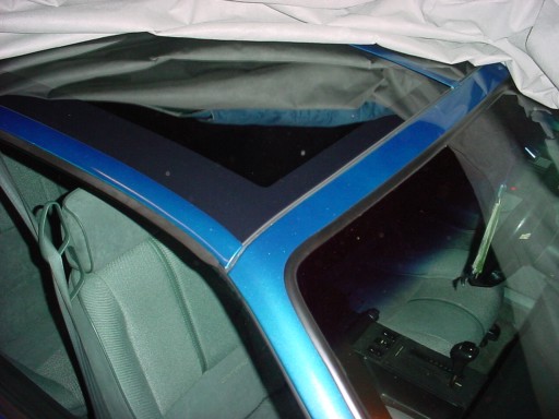

yeah i got the plastic parts from the dealer as well.
mine lookes like A$$!!! they were totally wrinkled, and lookin crappy.
i got the plastic ones which improved the look of the side of the car abouy 500%. definitely get them, and you will be happy. its amazing how well they look after you have been starting at the bad ones for a while.
here is a pic of the passenger's side. you can kinda see what it looks like....
-brian

Hey Brian, the trim pieces painted the body color looks really nice.
