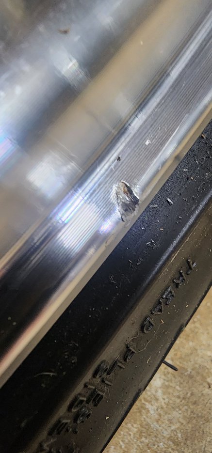

Wheel repair help
Do they sell anything I csn use to fill in the nick on this wheel and make it match?

Look up wheel repair shops. They can work wonders, some so good only you will know it was repaired.

Blend and polish it.

I'd be inclined to fill it with a bit of JB Weld. Carefully sand down a bit lower than the wheel surface. Then dab on a little silver nail polish to build it back up. Should be barely noticeable when done.
