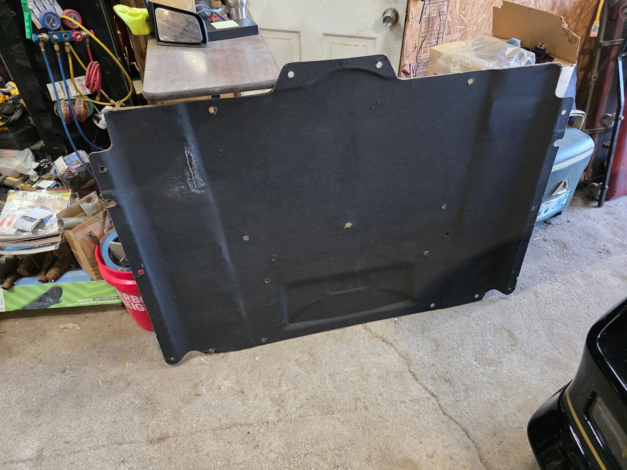

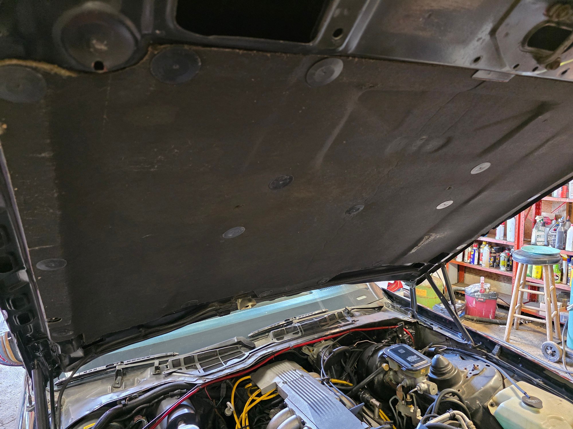

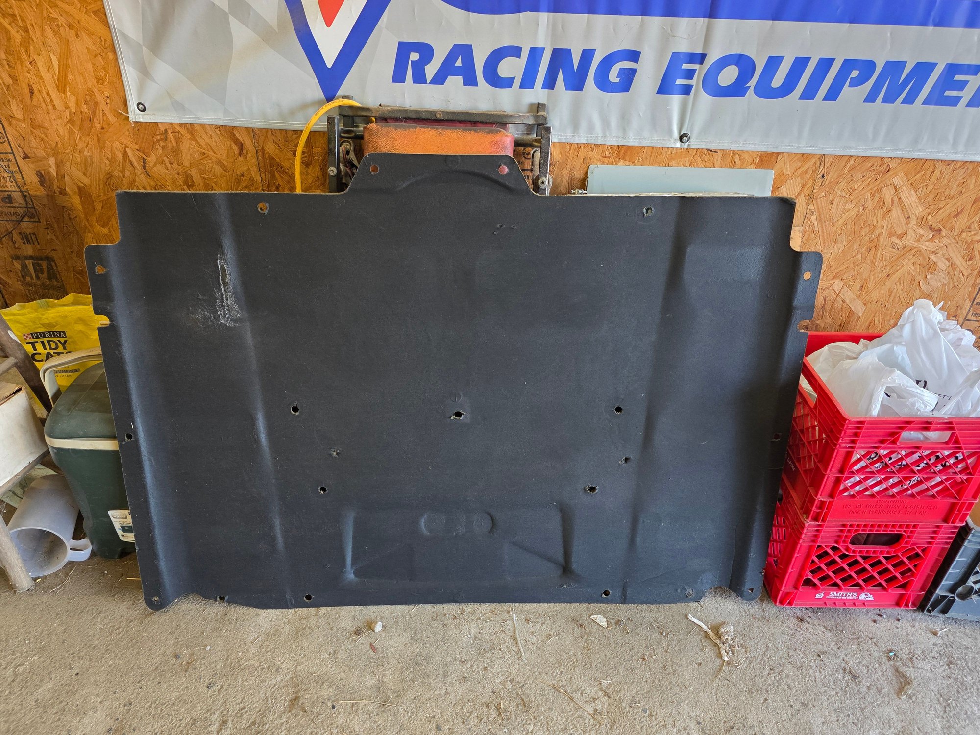

My hood insulation pad has been off the car for about 20 years now and I finally wanted to clean it up and install it. It was a bit stained, but in decent shape overall.

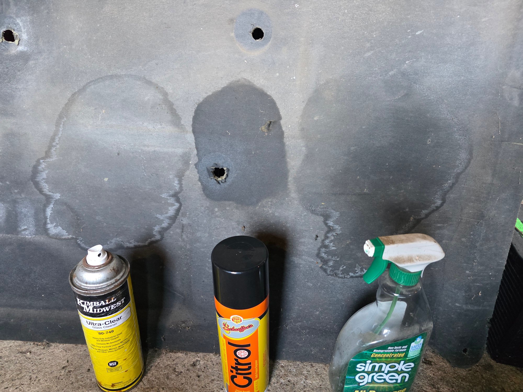

Since it is so delicate, you can't really do any scrubbing of any kind. So I needed a "magic" cleaner to spray on it and carefully blot it to hopefully make it look more clean. So I did a test with 3 different products I had on hand, then let it sit for a couple days before judging the results.
The Kimball Midwest glass cleaner and the Simple Green both soaked in and left a stain ring, not really changing the appearance at all. But the Schaeffer's cleaner didn't soak in and spread out, and it left a nice deep appearance, similar to how the liner would have looked when new. I don't know if that's because it disolved that much grime, or if it just has an oily residue that deepens the color. Either way, I chose the Schaeffer's.

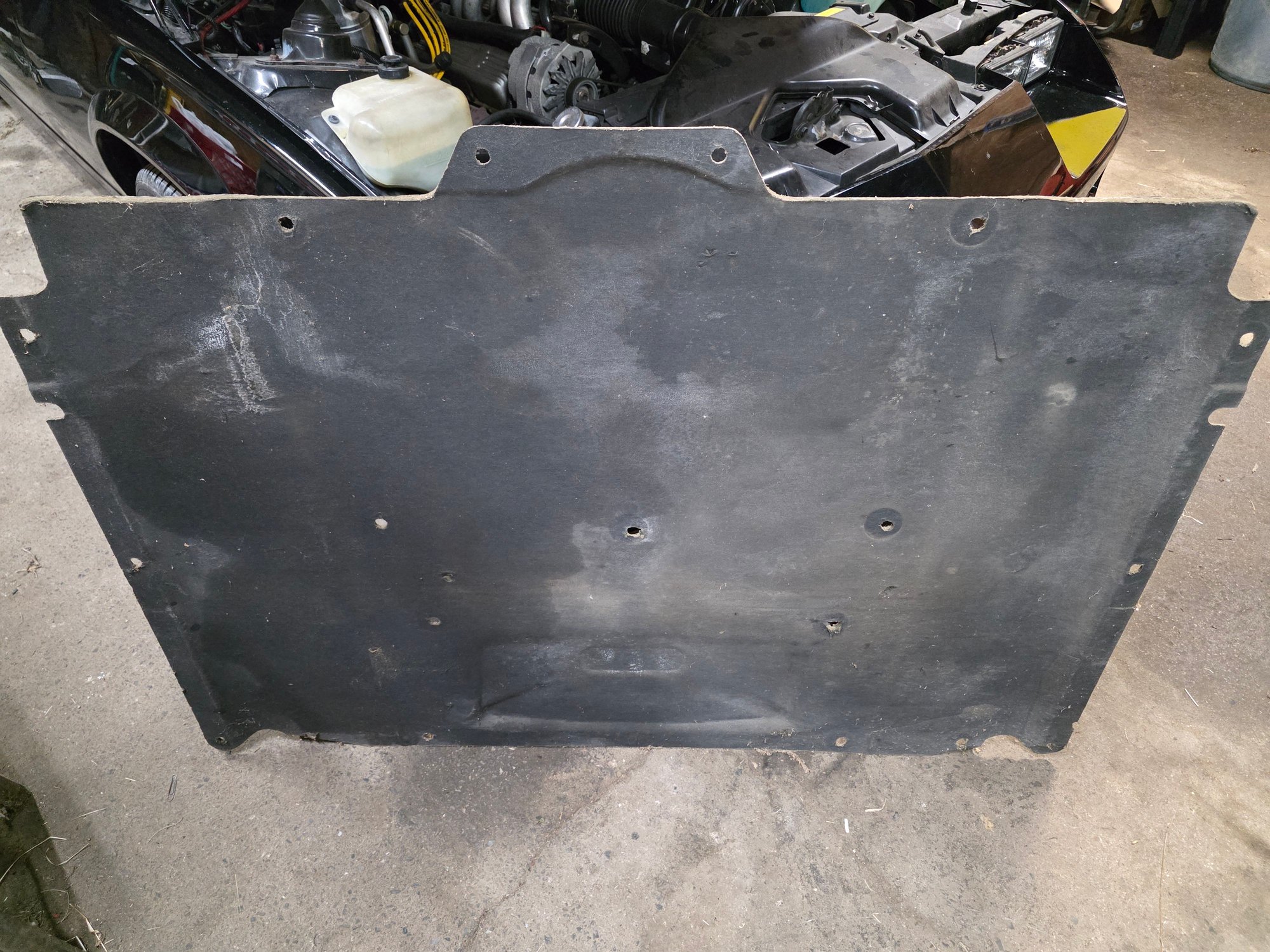

I left the pad sit another day and the appearance did not change at all. So on the car it went.
All in all, it looks presentable I think. There's a minor crease in the center area after installing it and there's a noticeable rub mark from the brake master reservoir. Plenty good enough for a car that I intend to start driving very often.

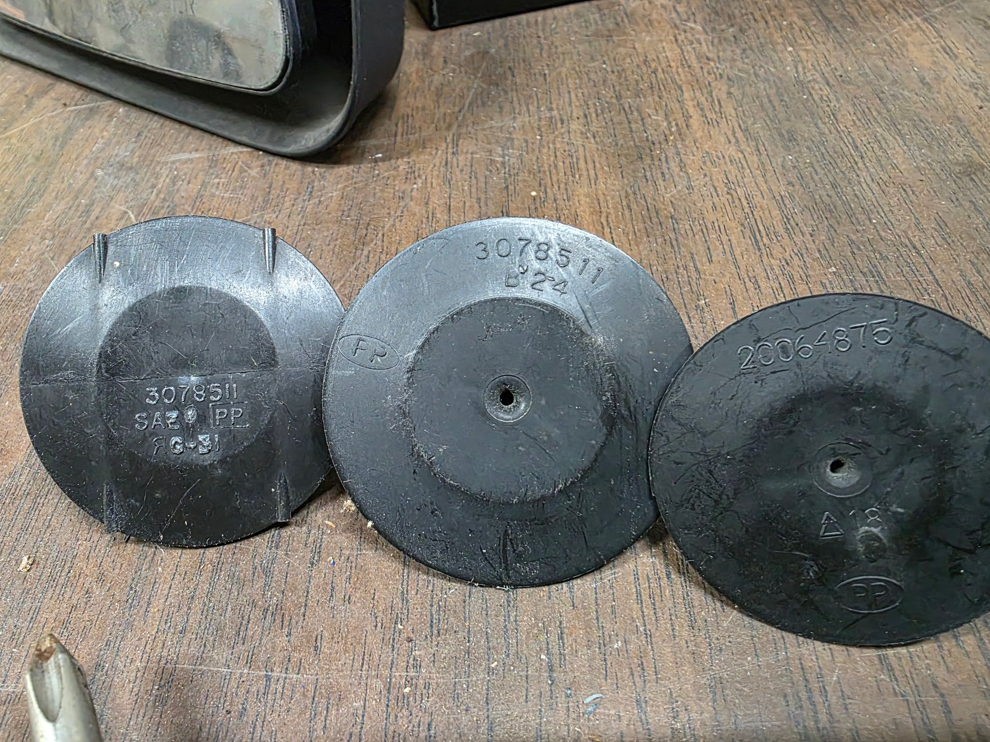

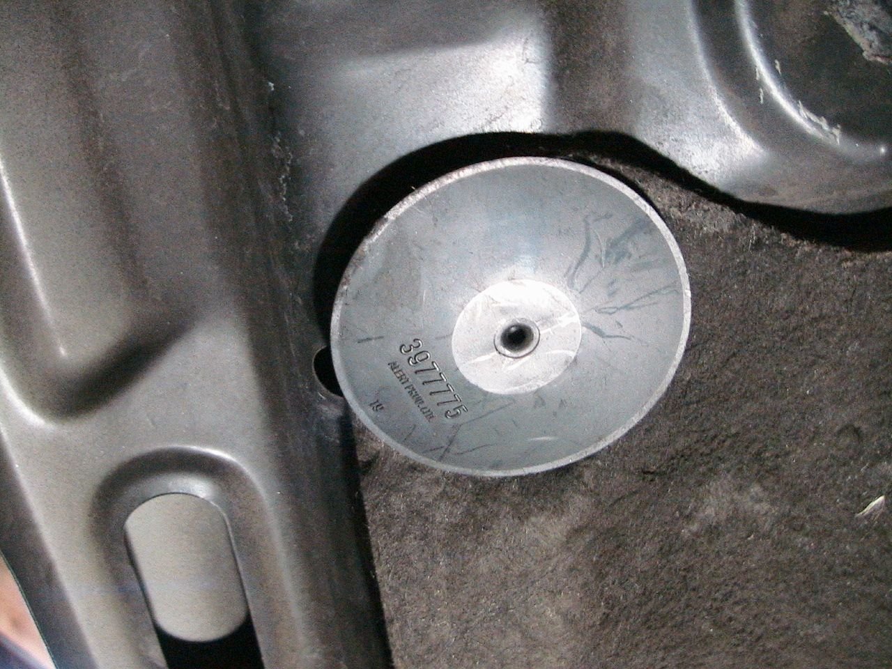

So upon further research, those clips I installed were most likely not the ones I removed 20+ years ago (I know the outboard ones are not, I installed those just for cosmetic reasons).
Here's the three styles I had in the bag that I was pulling from. On the left are the style I did not use. The center ones I used and thought they were original. The ones on the right are a little smaller and I used them on the outboard locations. If you notice, the left and center clips actually share a part number:

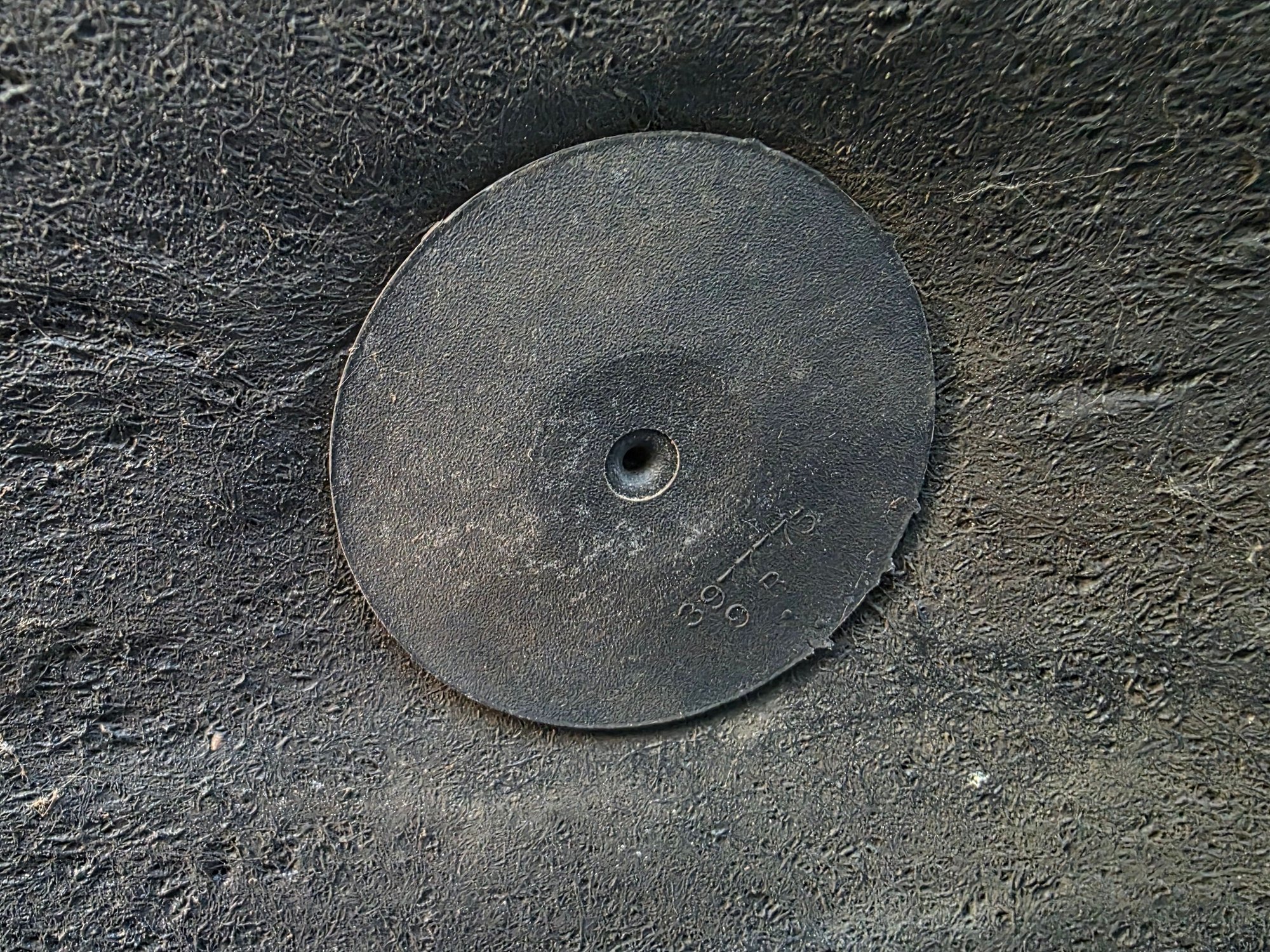

So then I checked to see what clips were on my untouched '85 and they were very similar to what I just installed, but not the same. The different part # can be seen:
So then I looked at my mostly untouched '92. Nearly identical and the same part number:
At this point I was very confused. Where the heck did I get the clips from in the first picture? So I checked everything around here that still had an original underhood liner. '79 C20, '86 Celebrity, '88 Celebrity, '88 Suburban, '89 K1500... they all used the same clips as my '85 and '92 Camaros.
I absolutely KNOW that I've dealt with a bunch of those clips with the 4 little raised tabs on them, but I don't remember where. I forgot to check my '00 Suburban though.
At any rate, the clips in pictures 2 and 3 are what I'd assume to be correct for all 3rd gens.

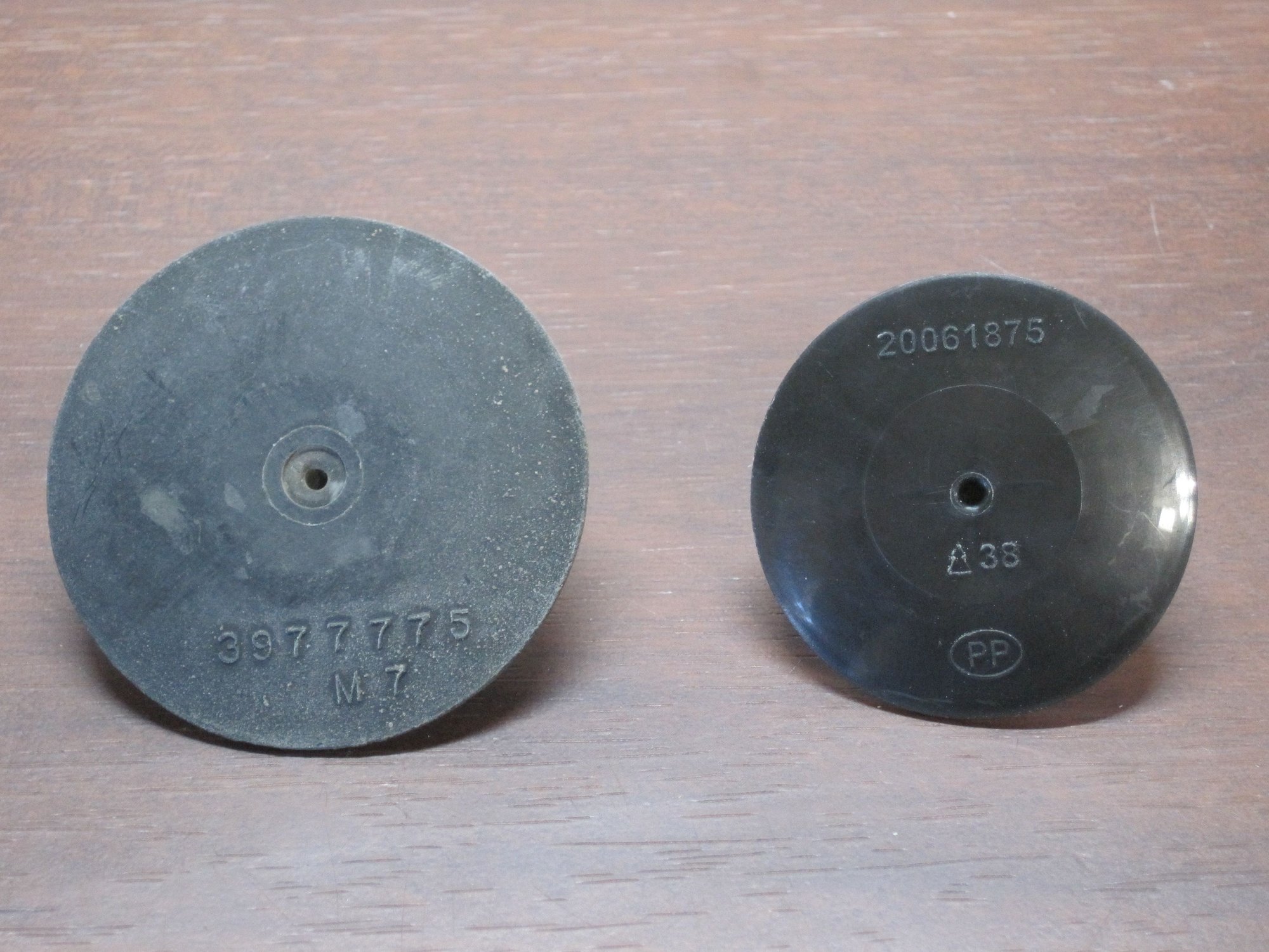

The one on the left is my original. The right is the replacement. That's all I could find.
It's interesting that our original 3977775 ones seem to be shaped just a little differently.
On top of that, they have different numbers underneath the 3977775: M7, M11, M13, M14, M21, M22, M24, M31. A few have "ALERT PROD. LTD." with the numbers 1, 3, or 8 below it.

I'm assuming the 3977775 clip was made at many different suppliers and is the reason for the minor differences and markings.
I also think that the clips tend to lose their dome over time. It may also depend on how hard they were pushed in and which of the "ribs" happened to engage in the hood.
