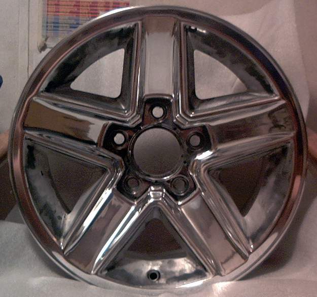

save yourself and plate them.

Not hard really. I use different techniques to polish mine.

Heres what I do.I also use my polishing wheels on bench grinders.
1. Use a die grinder with 120 grit and get in all tight areas or ones that a polishing wheel wont get.
2.Use 400 grit with the die grinder going over all spots that were covered in step 1.
3.Use the da sander with 180 grit to get every where else that needs to be sanded.
4.Go over the same areas with 320 grit with the da sander.
5.Use a blue wheel(made with carbon fibers)and use black grease compound. Go over all areas and get out all casting marks and scratches.
6.Use a yellow wheel(made from cloth) and use yellow grease compound. Do the same as step 5.
7.Clean the part and dry it.
8.Finish it off by using a buffing wheel and use white grease compound.
The stuff that I use is a little pricey but I is really better than doing it with only using sand paper.

Go to http://www.swmetal.com/ There you can buy all the polishing wheels and polishing compounds you will need. Do you have a bench grinder? Cause you will need one to put the polishing wheels on. If you have any other questions post it and i'll give the best answer to it. I painted that rim in the previous posts today. It looks much better painted, enjoy.
