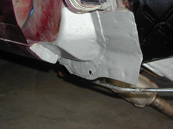

I use a wire wheel on a grinder on painted surfaces
so that I can tell how big an area I am dealing with.
This started out as a "bubble" about the size of a
quarter...

That was a spot between the door, fender and floorpan...
The scary part was that most of these areas were "protected"
by a variety of seam sealers used to cover the welds.
The worst area was the seam along the wheel well on the
inside floor pan.
The biggest problem was removing the "rubbery" stuff
Took days after the interior was removed...
I took to swearing at 1 minute intervals
The good part was that I learned about panel adhesives.
I screwed around with a number of products from
"Dura-Mix. The advantage of this stuff is that you can replace
relatively small sections of panels in tight spots with the
equivalent of glue. ( My welding technique is poor )
I used the por 15 epoxy as sealer to reasonably good effect...

Got your picture urbman.I had a big hole right in the same place due to the failure of very poorly applied factory seam sealer.I absolutely agree with re-applying your own quality sealer after removing the crumbling factory rubbish.I also blasted large amounts of cavity wax in any inaccesible area to halt corrosion.Just don't spray cavity wax until all paint jobs have finished or inside your garage/workshop.If a tiny particle of this lands on your wet paint it'll be fisheye.What was the grey primer you have applied?

The "primer" is POR-15 "silver"... fairly close in color
to what was there, a little lighter in person...
