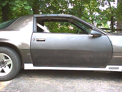

I want to thank AndyZ28 for his explaination on how the fixed door hinge hole was pre-measured for each car opening. I elongated the fixed holes ,slid back the door, No more binding.This is a junk-yard door cost $125.
