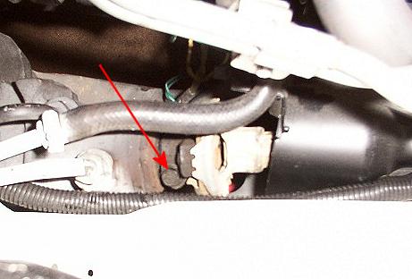

If you talking about the part in the pic below, IIRC the shaft on the steering gearbox has a 'keyway' so the intermediate shaft can only go on it one certain position (basically so you don't install the steering wheel X° offcenter)

no i'm having trouble on the other end of the intermediate shaft. But if i take it out back where your talking about will i get more control of the shaft? Would that help me at all? I think i would be doing ok if i could figure out how to get the coupling onto the column.

The other end should just slip on fairly easy, if not a little easier than the end I showed above (a little persuading from a nylon or deadblow hammer helps too). The end you're talking about will go on either way (0° or 180°).
You might try rounding the eldges of the i-shaft and the column shaft where they mate with a file in case there are any burrs since he fit is snug but, shouldn't be difficult to put back together. Taking the end off at the gearbox would allow a little more movement but, might be extra work for no progress.
