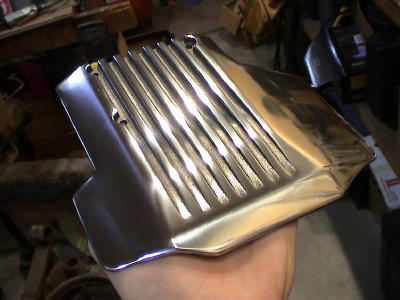

here is a pic in which i used buffing compounds...of my plenum extension...

Car: 87' Iroc
damn dude, that looks NICE, if my wheels come out good, i might polish my 350 before it goes in, lol, give the intake manifold and oil pan some TLC
