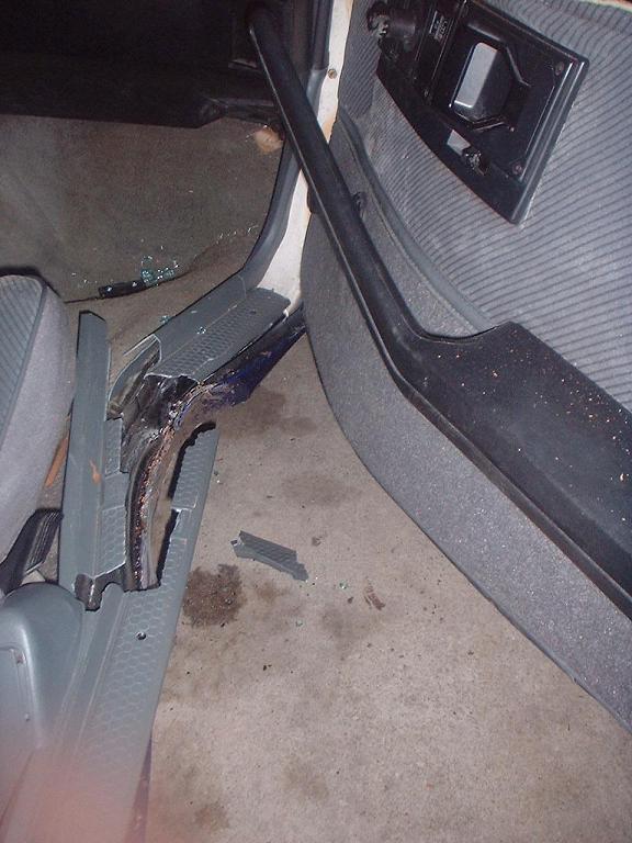

car pics 1

IMO--if you have full coverage insurance, they would definitely total it.
you really have to get under there(pull rug up and look under the car)to see what exactly it needs. If you're lucky it isn't that bad where maybe you can bang the hell out if and get it somewhat decent(dodoubt it tho )
have you tried to get some kind of an estimate? just let them know that you'd be paying for it out of your pocket.
Good luck.

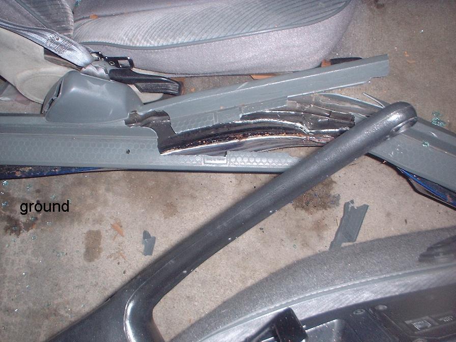

car pic 3

that can be fixed dude...you hook a winch to the section thats bent in the most..tighten the winch to the metal just starts coming out..then fire up your acetylene torch and heat up the entire area..by the time u shut off the torch and pick up a hammer itll be ready to tighten the winch as you go back in evolution 256,000 years and beat the crease down as you tighten the winch..
it wont be 100% perfect but really damn close> like hi 90's
get a set of subframes and your good to go..

i wouldnt even try fixing that, too much work, get the insurance payment (assuming you have collision), strip it for something, and buy another with a v8, and drive more carefully in the rain, sorry dude, good luck

the thing with the unibody frame is that all those annoying sounds that you hated before will only be amplified, even if the car is fixed 99%. also the body will never be perfectly straight again. however, if you strip the car you may be able to buy yourself another thirdgen for little out of your pocket. by the way. it was a nice car...

just to let you know, that big hump in front of the passenger's seat is factory, for the cat, the rest will take some work. I'd beat it out, then spend the $200 and have a frame shop pull it square

lol that hump has always been there for clearence for the cat.
Fixing that damage will time a lot of time and money.
