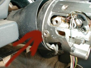

I got it down to this and I cant find out how to pull this one metal peice off. If anyone knows whats holding it on please tell me.
The problem was the wheel was loose as in it would shake up and down left and right even while in park. I found two screws inside this metal deal that are loose. I just need to get to it and its pretty much got me stumped. Good old haynes manual is as good as nothing as usual lol.
here is the pic. thanx ppl

oh and the bottom one with the arrow is a plastic cover I cant move either. Anyone know how to move that one any? thanx again.....

There are one of these on each side. Maybe they have to be pulled out, they cant screw in and the have a screw hole. Looks like I need some kinda pully (screw and a washer) lol

lol looks like this is what is going to remove it. Check out my ghetto tools. Got a screw from a regular household door ****, big washer and a socket. The perfect pully lol

You don't have to go that far to tighten them up look at the tech article
https://www.thirdgen.org/newdesign/t...ngcolumn.shtml
I have done it a few times on different cars, it works great, I did it before I discovered this site.
