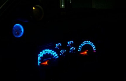

so does anyone have a completed picture of 91-92 gauge cluster with blue lights working?
would it require us to somehow remove the yellow plastic that the light shines through?
I just want my gauges to be brighter, and if im gonna make the effort to change the bulbs to LED or brighter style bulbs, I would prefer a blue backlight over orange.
Any pics?
Any pics?
look up oddesy in one of the LED threads... on the 2nd page, 2nd or 3rd reply... you can see his.
he has the whiteface/silver gauge overlays, but he removed the factory face... they glow blue numbers with red needles.
Old Dec 19, 2003 | 04:38 AM
Kingdomofmadnes's Avatar
Joined: Jun 2003
Posts: 44
From: sweden
Car: Camaro z-28-1992
Engine: 305tpi
Transmission: th700r
is this the one you mean???
this was the question about his pic
Odyssey are those the stock gauge faces or aftermarket overlays??
and Odyssey answear: those are stock guages with blue backlighting. But they do have the silver overlays from MacEwen so they can look better during the day too.
And im a dumb swede who dosent understand all american words,but "stock gagues"=orginal,or am i really lost??
yes.. stock usually means the orginal one as put on by the car maker...
his reply is a little misleading though... he has the stock(orginal) gauges, but rather then put the overlays over them, he removed the orginal background and replaced it with the overlay.
that way, the light could shine thru them without going thru the yellow first.
