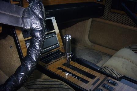

Post a pic of the aftermarket shifter on your car if you can.

I took a picture this weekend. I had to compress it for the site. I also updated my web page with the pictures.

my car had one of those in it at one point. Do yourself a favor and go find a factory **** and put back on it. Those ones are garbage and the set screw come loose causinf it to move and making it hard to shift like you are describing.
