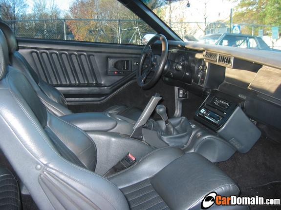

Need pic of 4 gen console in a Stock Dask Camaro
As the topic says I need a few pics of 4th gen Console with a stock camaro dash. I have a chance to buy a 2000 Trans Am console for $20.00. and what to see if I like the way it looks.
Please help me I did do a search but the only pic I seen was in a Firebird.

You don't need one, buy it and sell it to me for $40.00 you'd doublr your money
I have a pic on my other computer, i'll put it up later.

You will need to use a fire bird radio pod to make it fit. Just do a search for "4th gen console radio pod" and you will find the pic you want.

hmmm... are there any more available for this price? It's a heck of a deal and i'd love to get in on it. Like stated above, others have used a fireburd radio pod in congunction with a 4th gen console in 3rd gen camaros. Others have cut off the part of a 3rd gen camaro console that holds the radio and mated it up to the 4th gen console. There are definitely pictures out there of both methods if you do a search. In my opinion, the firebird radio pod approach looks better and is easier to do.

The main issue for me with the firebird pod is that you have to chop up the dash as the camaro pod is narrower. It also is gray, which matches nothing as it's a funny shade. Also note the lip that runs around the camaro opening, and one side will be funny looking as you cut off the lip. Done correctly the camaro pod is the way to go. Some have some hacked attempts at it though, just take your time.

Here's a pic i have on my PC, i plan on doing this to my Iroc i already have the pod, but have been unable to aquire a 97-02 manual console as of yet, so if you don't go for it hook me up.
I have a 93-96 T/A console in the Formula so thought i'd use the other style for the Iroc
