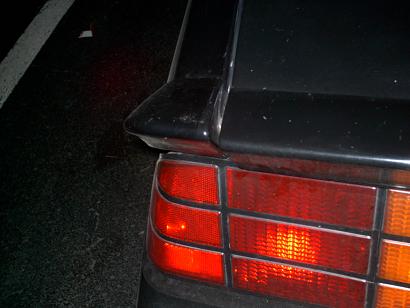

my hatch isnt quite lining up right with the sides of it... what is causing this? i put new sliders on the pull down and i tried to adjust the black alignment bumper things.... i dont know what the hell to do next.. but its pissing me off lol... looks like crap... any help?

see thats how it looks... how can i make it even?

You should be able to fix that with what I suggested doing in my last post. Do you happen to have a measurement of how "off" it is, it's a little hard to tell from the pic? Just curious.

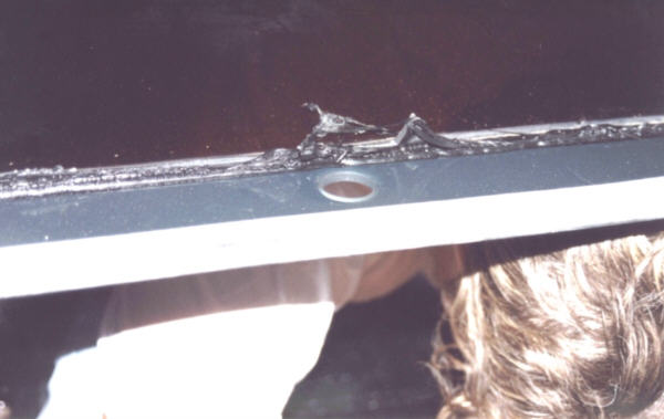

How he stated is how you adjust this. It could be very difficult to break the factory seal loose at first. The factory used this sticky gooy type sealer to help hold the deck lid to the glass.

ok awesome guys.. thanx alot for the very detailed explainations.. im going to try to do this tommorow.. sorry about the bad pic ... it was dark out obviously and it was hard getting a good shot... but just by guessing i think its like 1/2 inch off on the drivers side and a little less on the other.. its really weird... also can u buy new adjustment bumper things? j/w.. thanx again ill post pics when i fix it...:hail: :hail: :hail: :hail: :hail: :hail: :yourock:

never found out teh proper way myself. Took the one off the 82 and my 87. With both I had friends holding and helping. WE took all the nuts off. Took of the struts. Then kind of gently pushed up on the decklid till it started to let go. We had to rock it and pry it loose. The glass is blasted heavy and I would recommend bracing it to keep it from damage.

my firebird has the same problem, and is pretyt much the same design, the deck panel sits on the end of the glass and is glued to it black urethane sealer, and underneath are the nuts that go on the studs that go through holes in the glass or after it or whatever, well you can adjust the deck alignment with those nuts, and you can adjust trhe glass alignment at the hinges, the nuts are up in the upper hatch frame under the headlinder rear panel trim,
