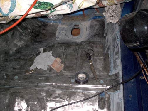

Basically doing the same thing your doin for the last couple of weeks. My seat was all the way forward and all I had to do was use an open end wrench.
As for the POR prep. Im also about to put down some por-15 so I have been tearing apart the floor for the past few weeks. I didn't really have any rust surprisingly!!! even with my horrible 8+ year t top leak. But basically since you do have rust just get rid of all the loose stuff. Por loves to be coated over rust.
What I have been doing is sanding my entire floor pan to bare metal. Im tearing out the crap seam sealer too. As for all the cracks I just used a wire wheel on my drill to strip the paint right up to where panels meet or overlap. I wish I knew of a way to get in places like the INSIDE of seat rails that are welded to the floor.
