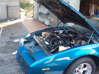

My hood shocks dont do s%$#.Im going to get new ones and I looked at the one I have in there and there riveted in.My question is when I get new ones do I need to rivet them back in or can I use bolts and nuts?

If you look closer they are clips on there just pop them off and they should come out. The rivets are the pivot points for the struts they are not attached hope this helps.
