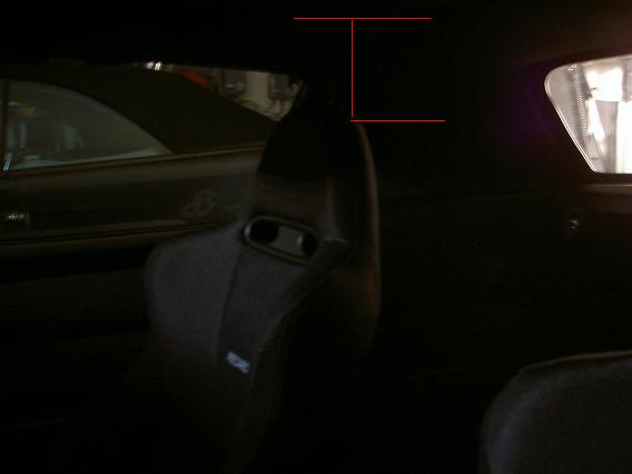

Got my torinos today i absolutely love them there 1000 x's nicer then i could imagine. The only thing that sucks is the brackets they sit way too high and the seats are close to the door so i guess ill have to run a low door bar on my cage. Got any opinions?? I got 2 seats 1 only together for now.
The top of the seat almost hits the roof.
http://memimage.cardomain.net/member...4_103_full.jpg
Heres what i was thinking of doing with the bracket.

OK yet another problem the adjuster on the console side hits the console. Im pissed nothin ever fits the first time why why why. I thought someone on here had them in there car. Also is a 4th gen console skinnier then a 3rd gen cause i was going to get one.

Ahhhhhhhhhh why didnt i know this before i spent alot just on these brackets. Any one know about the center console im sure i can just take the adjuster off on that side though if i have too.

What problems did you have with the corbeau's kandied. Im sure i can get these to fit good its just a pain after i tought they would fit fine.

recaro doesn't even make brackets for our cars so they sent me those and universal sliders for them.
I have Recaro's from a Recaro TA and the brackets were very basic. I only got three and made the fourth one up in fifteen minutes. Very basic and if you guys are having trouble I could post up pics when I get the car into the shop this week.
Funny though cause mine sat too low I shimmed them up an inch and they fit nicely now. I dont think the seats were made special for third gens either... I think they are "Ride n Joy" model.

Yeh my stock sliders wernt in the best condition though. It was pretty dumb of me not to research more on the sliders but i figured since they were made for the car they would fit how could they sell somethin like that is beyond me. My brackets were for any 82-02.

ask corbeau the same question... they must think everyone that drives an f-body is 5'2"

Yeh well im 6'2" and im pissed I think it would be wiser to **** off the little guys lol. Ok i called wedge and they actually make everything but the sliders i have. They said they have a diff part number for the 82-92 might be a tad lower but he isnt sure well screw this i will mod them and make them better. Then maybe i should take some pictures and show them how its done on a f-body. Im not drivin a fricken semi here i got 4 wheels not 18.

all issues i went with the corbeau. i feel your pain.
just recieved my recaros a few moments ago. seats look great. my quick recline mechanisms are broke though. it's always something...

Heres the pass seats its a lil closer to the door made that way cause of the ebrake i guess. I also hate the hump on the pass side its stupid not like they needed that big of a cat anyway. Its all good tho i like em and im satisfied now with how they fit.
Dusty arm rest

Car: 86 Iroc-Z28
Engine: FB385
Nice install there, and great seats. Changes my mind on the two tone look for those seats. All black looks real nice in actual photos.
