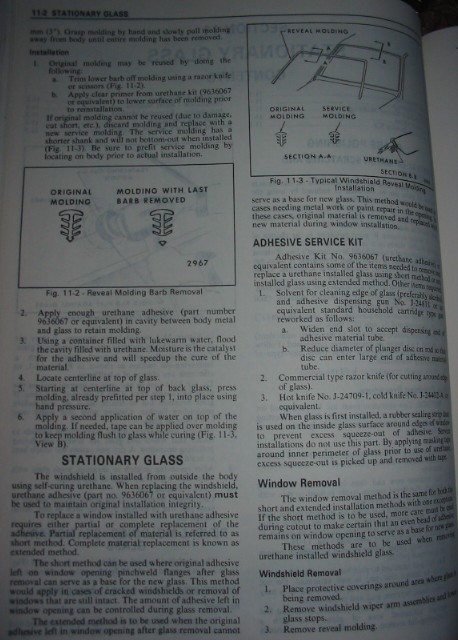

If you still want to try this.Here is a "how to" from the factory service manual.
Attached Thumbnails installing windshield...any tips?-c-documents-settings-rick

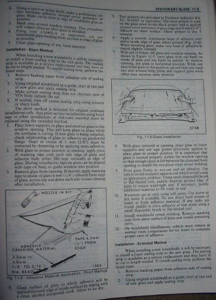

Page 2.Sorry for the pic.If you want i can email them to you.My scanner makes them TOO big for this post.

now there we go. thanks to the last 2 guys that had enough ***** so give me some real advise i can use. Thanks alot guys you answered all the questions i had. I have access to the urethane,etc through my works body shop,so im gonna go for it, either this weekend or sometime next week. The care im taking the windshield out of is going to the junkpile anyways,so worst case ill cut the metal off around the windshield and strip the remaining metal off the windshield carefully on the bench. If anybody else can actually think of anything else i need to know,BECIDES " DONT DO IT YOURSELF MONEY IS NO OBJECT,HAVE SOMEBODY ELSE THAT YOU DONT KNOW PUT IT IN" then hit me whit it yo. thanks guys(those who have actually helped me out with some tips)
