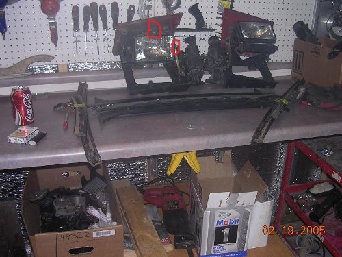

i was wondering how u even out the lights on our cars, do u just turn the ***** untill its where u want them? and i was wondering when i drive it up 2 a wall when its dark to even em out, how high should the light be? and how far from the wall? sorry...i havent done this before, everyone flashes thier lights at me at night so..i know theyre high right now,lol

Kind of crappy pic but all i had. With the headlights up there should be 2 little openings. In that black plastic filler. The to adjusters are there. The top one is your up and down. the side one is your left and right. If your lights are pointing to the sky the spring might have came off.U have to put that back on first before u can adjust them.

yeah my driver side light is pointed up
