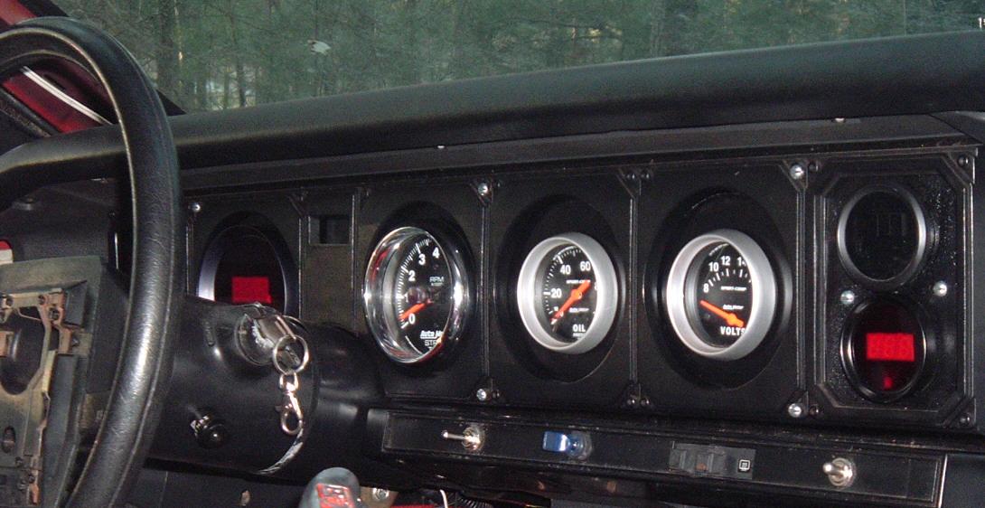

Here's a panel we made for my dad's 82 firebird.
Dont mind the mis matched gauges. We used what we had laying around.
The only stock wire we used was the pink fuel level sender wire. The rest we ran our selfs.
