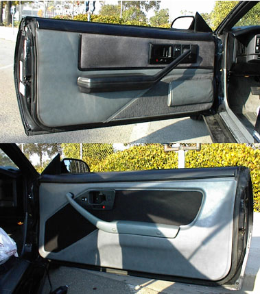

before & after
Attached Thumbnails GTA door panel mod-c-documents-settings-zach
Old Mar 22, 2005 | 09:29 PM
82firebird's Avatar
Posts: 2,033
From: North Canton, Ohio
Car: 1982 Firebird
Engine: sbc 307
Transmission: 200
Did you have to change the actual handles as well as the arm rest brackets? I want to install the deluxe style handle trim on my 82, but there seems to be no place for the trim to mount to.
