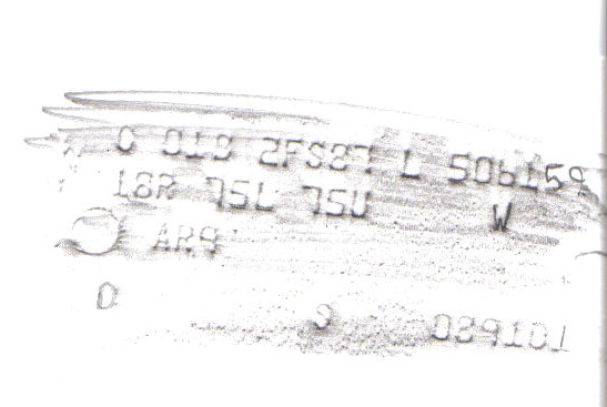

well as i said i'm not very good with cars at all.
I thought those were the color codes but apparently they werent.
I couldnt take a good picture so here is a scan of a pencil paper thing i made.

The numbers you want are the 75L and 75U, those are the upper and lower color codes
That color is called Spectra Red, and it is a water based paint due to the W being on the cowl tag
