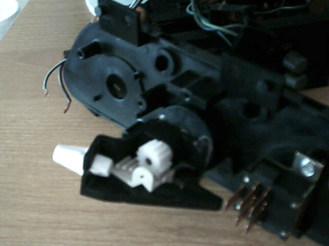

ok so see the yellow circle in the pic, straight down on the bottom part, is that where you mounted it? this is my air box since i dont have A/C. but it opens and closes a door, im assuming its a hot/cold door?
Old Jun 27, 2006 | 10:07 PM
  #81
Faded's Avatar
Joined: May 2003
Posts: 744
From: California
Car: '91 Firebird
The door that needs to open and close for hot/cold is in the hole I circled in white.
Find the pivot point directly below that door, that is where the cable hooks up.

d10pins can u go into some details about the 4th gen hot/cold cable. it looks like you have a screw goin throught he middle with a washer on top also. is that the "old" 3rd gen hot/cold cable on top are you using that?
how is it exactly going to work the old cable is pull/push style, and the 4th gen is rotating.
Old Jul 10, 2006 | 01:41 PM
  #94
1991Convertible's Avatar
Joined: Jul 2006
Posts: 11
im using the 4th gen cable. i made a bracket first to anchor the cable housing thing,(the big black plastic piece. then i made a spacer and filied two flat spot on each side so the spacer would fit in the opening. drilled a hole in the center of it and screwed it in to the swinging piece on the airbox.
Darin

was your old hot/cold cable a pull style cable? meaning with your old heater controls when you switch to hot/cold, when you switched to heat say it hauled on the cable, then when you switched to cold it pulled the cable back?
this is my dilemma, where the hot/cold cable is for it looks the same as yours except mine when the door opens and closes the "pin" underneath where you attach the cable housing goes back and forth. will this setup still work?
and i will need to go over what you said again. so you made a bracket so the housing would stay underneath and not move around correct? did you bolt it beside the pin so it would move when the door open closes or elsewhere so the housing doesnt sway back and forth when the door open/closes?
what do you mean you made a spacer and filled two flat spots on each side so the spacer would fit in the opening? something small enough to fit in the middle where the hole is?
did you get rid of the pin holding the door altogether and put in a screw?
yes in get rid of the two pins on there. drill a small hole and run a tap through it and the put a screw in there, through the spacer. i bolted the bracket through the flat slot where the 3rd gen cable snapped to.
