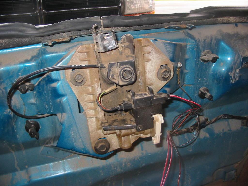

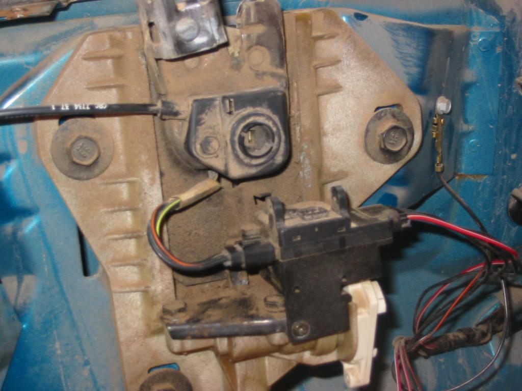

What's missing from my hatch pulldown?
Ok guys, Here's some pics of my hatch pulldown. I've owned the car about 2 yrs and it's never worked. Decided to take a look at it today and realized that the motor is missing...probably more.
I'm considering ordering the parts to fix it from TDS, I just need to know everything i need to get.
Thanks for looking...
Wayne
Attached Thumbnails Replacing motor that pulls down deck lid-pulldown1.jpg   Replacing motor that pulls down deck lid-pulldown2.jpg

Yours is a 1991-92 motor. New motors aren't available to my knowledge, but I have the used parts to rebuild or replace yours. Contact me.
Lon
