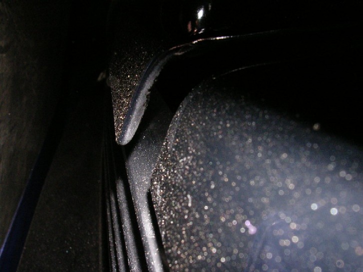

Hatch Alignment
I have read the Tech article 101 on hatch alignment and done a search for treads on hatch realignment. My hatch sticks out too far and also sticks up on the drivers side. The Tech article describes how to move the hatch in so it lines up with the rear fender but I can't find a satisfactory answer on how to solve the problem of the hatch sticking up on one side. Some posts say that the hatch can be realigned by adjusting the hinge bolts under the headliner trim panel which is over the rear seats but I don't think that will solve my problem. I have included it a picture but it is a isn't great but can give you the idea. I don't why the deck lid is raised on one side maybe it is because it has a wiper motor and there is more weight on the passenger side.
Thanks.

gohlian i think i know what your prob is. does one side of your hatch sit higher than the other? if so your hatch seal is getting in the way of the under trim panel causing it to sit up.
as for the alignment skip reading the tech article and do what i did. yank the struts, loosen the nuts under the headliner to hatch trim panel, drop your hatch latch and lower the lid. after that just push forward with the lid down and it will move around where ya need it. dont loosen the nuts too much as they will wedge when ya scoot the glass up. after i got the hatch where i wanted it i cinched the bolts down and all is stright.
as for your seal, your gonna hafta replace it. the seal is warped from being leaned forward and cant be made right, i was lucky to have 2 parts formulas to get mine from and 1 of the 2 were good.
kool thing about this is i did it without help like the tech article sugguest and no worries of a busted glass.

all of these things just tend to get out of alignment. you have a 100 pound hatch sitting on two hinges and a latch, it'll happen.
either
a. it is just misaligned at the hinges. loosen and adjust.
b. the bump stops are badly worn, sometimes unevenly, making it worse. Delete them and experiment with different thicknesses of square rubber. when satisfactory, epoxy in place.
c. the weatherseal is messed up and is folded/warped up into the path of the hatch, not allowing it to close evenly.
d. one hatch strut is way stronger than the other.
e. if the glass is perfectly even all around, sometimes the decklid is still not spot on. people sitting on it, hanging on it while open, lifting from one corner, etc. can all tweak the decklid without tweaking the glass. a couple people on here have peeled it off and re-attached it due to this. i feel they probably could have solved it with more patience, but maybe not, keep it in mind.
f. your car is twisted. sucks, but i guess you have live with it.
i had to do a, b, c, and d to get my hatch right. The new (junkyard) weatherstripping evened it out. Then I had to get the right bumpstops in there to get it at the right height. then i adjusted it up and down at the hinges to get the spoiler lined up. it would still open crooked and i could tell it would warp it again, so i got new hatch struts and was finally done.
It took about a week. 15 to 30 minutes a day, lil adjustments here and there. buying different pieces of rubber at the hardware store everyday, lol. but it looks great, and now my hatch struts lift the hatch by themselves when i hit the release. i've had like 10 people stop me in the parking lot over the past year since i did it, asking if it was motorized, lol.

Thanks guys for replying. I have installed a new hatch seal so it is not the seal that is causing the hatch to lift. I also have new struts fitted. I personally think that the metal part of the hatch has become warped over time. I will try and adjust the hatch at the hinges as suggested and see what happens. The hatch is very well alined with the rest of the car so I hope that If I adjust at the hinges it won't cause any alinement problems.
Thanks for your help.

I looked at the hatch when I went home last night and it is perfectly aligned on all sides. It is just on the passenger side that the lid sticks out about 1/4 inch and sticks up about 1/8 inch. I think that the metal part of the hatch has become warped due to as some of you said "lifting the hatch from one corner". I don't really want to try adjust at the hinges as I think that would cause the alignment to go out. I was wondering is it possible to adjust the hatch latch down so the lid closes tighter.

how far away from the roof is the glass? it may be stright but still needing to be scooted up. if the glass is about 1/4 or closer than id say yes you would need to look at the panel and make the adj but if you are further than 1/4 the its your glass, not the hatch panel.
another thing i could sugguest is to remove the trim panel under the hatch where the latch is and look at where the glass and panel meets to see if there are signs of slippage of the deck panel on the glass. this will save you some un needed work and help pinpoint the actual problem. i have a free evening tomm and i can look at mine as well to help find points to observe.

The glass is only about 1/4in from the roof and is perfectly even all round bar on the passenger side where the hatch sticks out 1/4 in. It is just the hatch panel that needs to be moved up as far as I can see. Thanks for the advice I will check the bolts under the hatch to see if the panel has moved. If you could let me know of anything else I should observe that would be great.

Originally Posted by wjames915
Hatch fram could be warped~. Something to have a body shop look at!!
They'll just stick a small piece of 2X4 under the low side and push down slightly on the high side until it seats correctly and charge you an hour labor. You can DIY for free.
