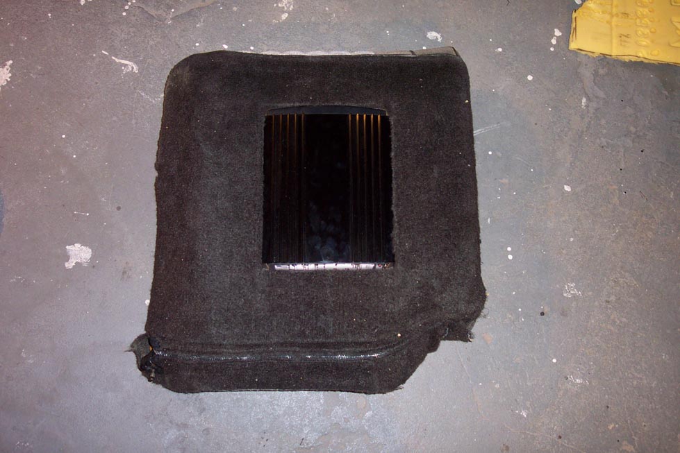

There used to be a tech article about mounting amps inside the back seat of a thirdgen. Does anyone have that link? It doesn't seem to be a tech article anymore. I'd like to mount the computer which looks exactly like an amp in the backseat.

Wow! That is really really slick! As far as mounting it in the back of the rear seat, just make sure the computer has room to breath.

Old Dec 19, 2006 | 08:42 PM
  #50
Nightcruzer's Avatar
Joined: Oct 1999
Posts: 762
From: Brooklyn, NY, USA
Car: Trans Am
tire pressure & temp monitor monitor
Toe: Thanks and good luck with your engine install, I don't think I could go entire seasons without driving my 'bird, I'd get too depressed.
Ghetto: The tire pressure & temp monitor is the best one recommended by Consumer Reports. They tested a bunch of them and I bought the one with the best ratings. Not only was it rated excellent but also in the moddle of the price ranges.
It is called Intellivalve, costs abour $250 and can be found here:
http://www.intellivalve.com/
Basically the tire valve stems are attached to a pressure & temp transmitter.
The lcd screen and attached electronics are a wireless receiver and display. When you go to the website it will be really clear. All I did was remove the screen and electronic guts from the plastic case (4 screws) and screwed it to the center console. I then cut a piece of ABS with scissors to make the "bezel", and added a rocker switch to manually power on and off, instead of plugging it into the lighter socket. You'll want the "off" ability since it unmistakebly warns you of low pressure with a sharp, SHARP, LOUD piercing alarm.
Anyway....I digress.
I have already created the "amp rack" inside the backseat, Just a couple of more details and more pics and a new "how to" will follow. I am getting giddy.
Until next time....a few teaser shots of the hardware install
Attached Thumbnails Carputer in Trans Am-carputer-inside-back-seat   Carputer in Trans Am-carputer-inside-back-seat
