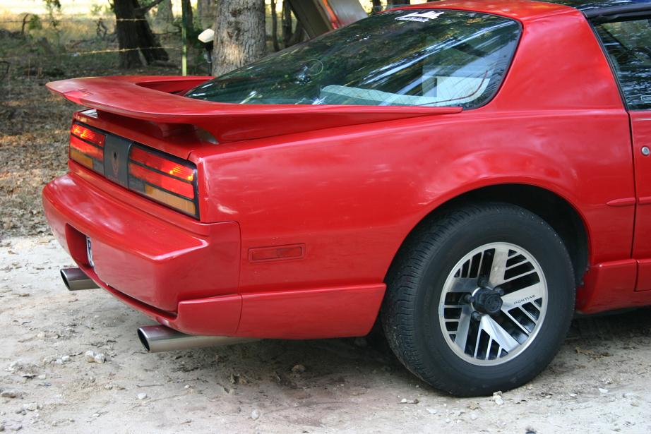

I just picked it up Thursday night. I didn't have time to work on it until last night. In less than an hour I had the old flat base bird wing off and the new 4th gen T/A wing bolted to the car. I had to fab up some center post extensions. The extensions took about an hour to make and I let them cure over night. This morning I shaped them out and painted them. I've got around 3 hours total in the install, fabrication, and paint. $100 for the wing and 3 hours worth of work beats the hell out of $400+ for the wing that's made to fit 3rd gens. This is actually a really easy mod to do. I still have a little tweaking here and there to do like bondoing the edges of the post extensions to the original center posts so it's seamless, but for now I'm happy with it and it's not that noticeable. I still need to weld up the holes from the old wing but for now I've got bolts in the holes.
Attached Thumbnails Another 4th gen wing.....installed-4th-gen-wing-installed   Another 4th gen wing.....installed-4th-gen-wing-installed   Another 4th gen wing.....installed-4th-gen-wing-installed

Personally, I think 4th gen wings belong on 4th gens, only.
But, taste is subjective.
Nice job on saving cash by mounting one yourself, rather than buying the pricey models for thirdgens.

I think it looks great! You do anything to hold the arms down? I love those spoilers on 91-92 cars.

I don't have anything holding the arms down at them moment. I didn't really see a need for it, they're really stiff and I shaped the tips of the arms down to make them sit tight on the quarter panels. They do have pieces of weatherstripping ruber under them to keep them from scratching up the car. when the hatch closes the whole wing sit's flush and tight.

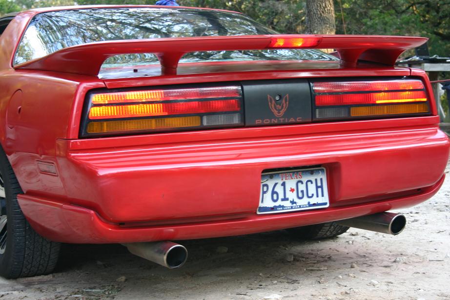

I'm not a fan of the wing on 3rd gens personally. But good job on the center extensions.
Did you swap hatches? or just disconnect the factory third brake light?
Acutally, on second glance, looks like you have the spoliers brake light wired with the parking lights....

It's still got the original hatch. A buddy has an extra hatch without the brake light in it, I might get it in the future.
The original third brake light didn't work anymore. The little reflector piece that holds the bulb inside the housing was sun baked & brittle so it fell apart.
I took pics of it with the brake pedal pressed (a stick between the front of the seat and the pedal). I've got 4 running lights on each side of the car. With the brake pressed only the 2 outter lights on each side light up along with the brake light in the wing.

it's amazing how only the posts need to be extended to make the 4th gne spoiler fit so well. It's tight to the glass and matches the width of the decklid and fenders perfectly. I think it'd look great with some 91-92 T/A tail lights... of course they cost a fortune. Even 85-90 T/A tail lights would look great on it.

I’m starting to wonder if it was massaged a little, mostly the edges squared off some to match the lines of the 3rd gens better
The only "massaging" done to it was a very slight trimming on the bottoms of the "arms". And that was only about the first 6-7" from the tips. I took about 3/16-1/4" off the bottoms of the arm tips so it wouldn't hit the tops of the quarter panels when the hatch was closed. Other than that it just bolts right on. Well, you have to extend the center posts if you want it to look and sit right.

The sublte rounded edges on it match my 91 perfectly, but 91-92 are more rounded. I think it looks almost stock. The angle of the wing is the exact same angle of the big GFX on my doors.
I'm sure you could square it off a little, but it really doesn't need it. It's really not that rounded when you see it in person, I mean the whole top of if is flat, which matches the top of the hatch.
