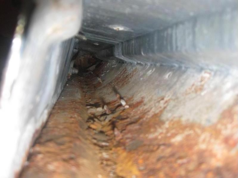

So went out to get the floor pan trimmed and ready to put in and realized how shitty the inside of my frame rail is. So this need to be redone before the floor.
I had to chisel out the the tranny cross member bolts.
