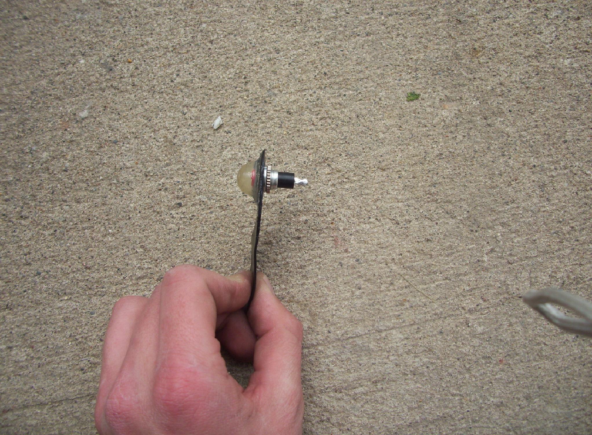

Ok, I finally got the Camaro in the garage, and since I wanted to grease the passenger side solenoid, I figured I'd take some pics and post them up to answer some of the questions about location and such that were raised earlier in this thread. The solenoids I have are Autolocs, but others should be similar enough in design. The pics show where on the door I mounted it, however I would suggest moving it slightly closer to the jamb side of the door(to the right in the pic) as the cable is to close to horizontal to work 100% properly. It opens the door fine, but the latch doesn't always grab when I go to close it. Might be the latch itself though, either way its my own stupid fault on that.
Sorry about the pic quality, all I had with me was my cell phone. The wife won't let me take the good digital camera into the garage.

Now for the exploded views of the solenoid. The black end cap is held on with 2 screws. After removing those, you can turn the cap gently to the side, the wire to the + terminal is not long enough to actually move the cap away from the body of the solenoid at all. There is a paper/cork ring gasket that seals the perimeter of the connection to keep water out. If you look into the back of the solenoid you can see the little e-clip that holds the plunger in place and a little crush sleeve that keeps the e-clip in place. Push the plunger into the body of the solenoid and you can open up the little crush sleeve that keeps the e-clip in place and remove the clip with a pair of needle-nose pliers. That little e-clip is what broke on my driver's side solenoid back in October. Once the e-clip is removed you can pull the plunger and its return spring out of the opposite end of the solenoid body. I cleaned up the plunger and the inside of the solenoid body with a small brass wire brush and some 150 grit sandpaper. Then I smeared some moly chassis lube on both and put it all back together.

Here are the rest of the pics.

Well I finally got that button attached like I had talked about. Took me long enough. I will post it on here and hopefully not be hijacking this thread. I posted a video of it on youtube. The first time I press the button the car is running and then I shut off the car and tried the button again. Here's the page:
http://www.youtube.com/watch?v=Z8_s0EOvC1Q

Re: are you shaved
Looks good. Now all you need to do is post the wiring diagram/instructions

Re: are you shaved
Think about it....
You stop, turn the engine off (but leave the key in the ignition, in the Off position), fumble around inside/talk on your cell...Whatever.
Lock the doors, you hop out, shut the door.......
Now your keys are inside, so if you have an alarm that can trigger the poppers, you can't do that. Nor does your hidden button work, because the ignition is off. Your now locked out, the keys inside & your hidden button doesn't work.
Might wanna rethink the button wiring, to make it of any use. Nice concept, bad execution.

I first found a spot to hide the button and by the drivers windshield wiper was the best spot. I then cut out a bracket out of steel and drilled the holes and bent it to fit perfect. A rustproof paint was used to keep the bracket from falling apart. Then I put in the momentary button and put a “fuel primer bubble” from a weed eater over the button. Then super glued the bubble down and surrounded it with silicone to make the top water proof. Then I soldered the wire on the back of the button and COMPLETELY covered that in silicone and waterproofed it. Button done and ready.

Re: are you shaved
Having the button not work is good for security purposes, but also makes it useless.
Think about it....
