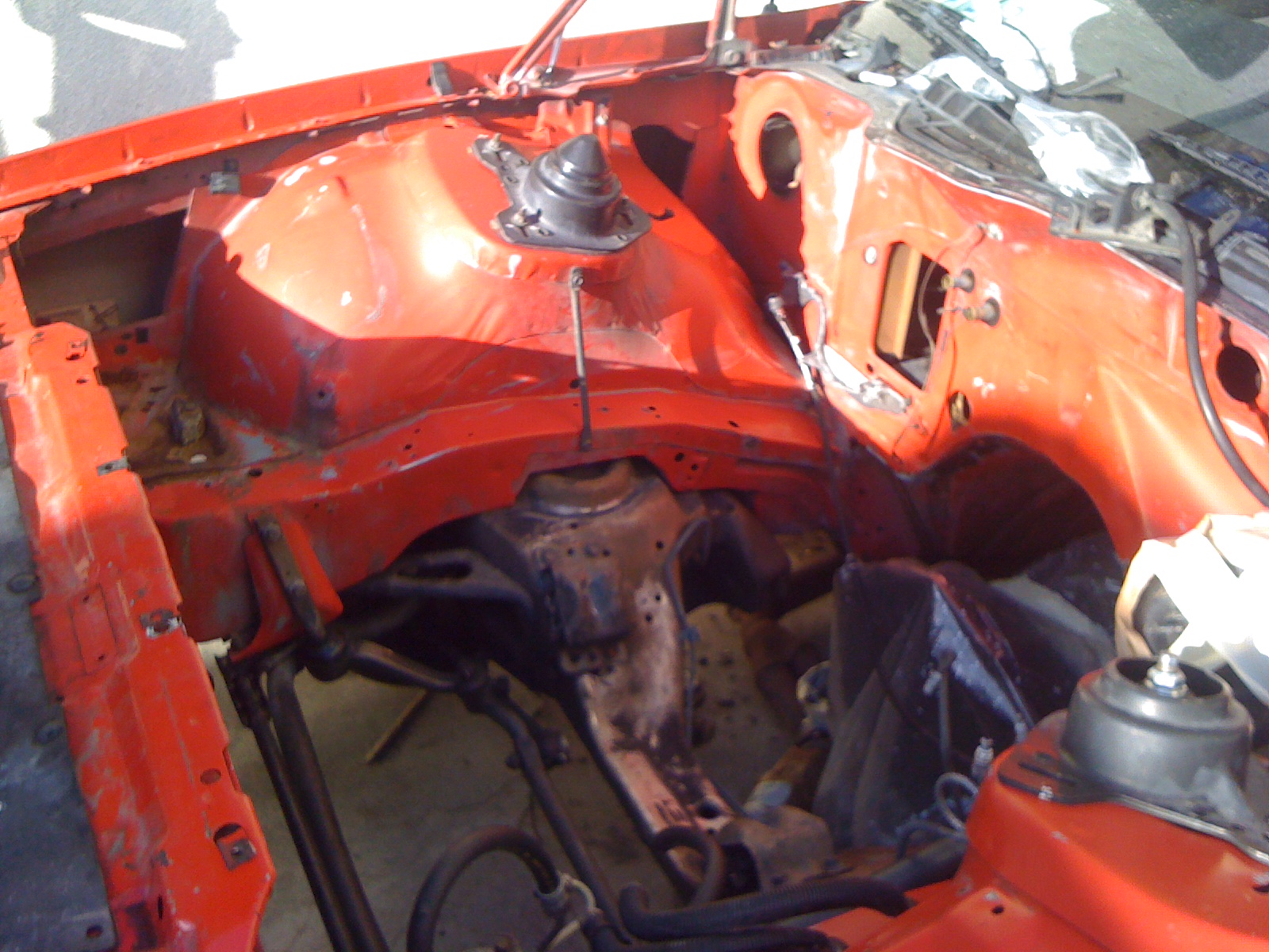

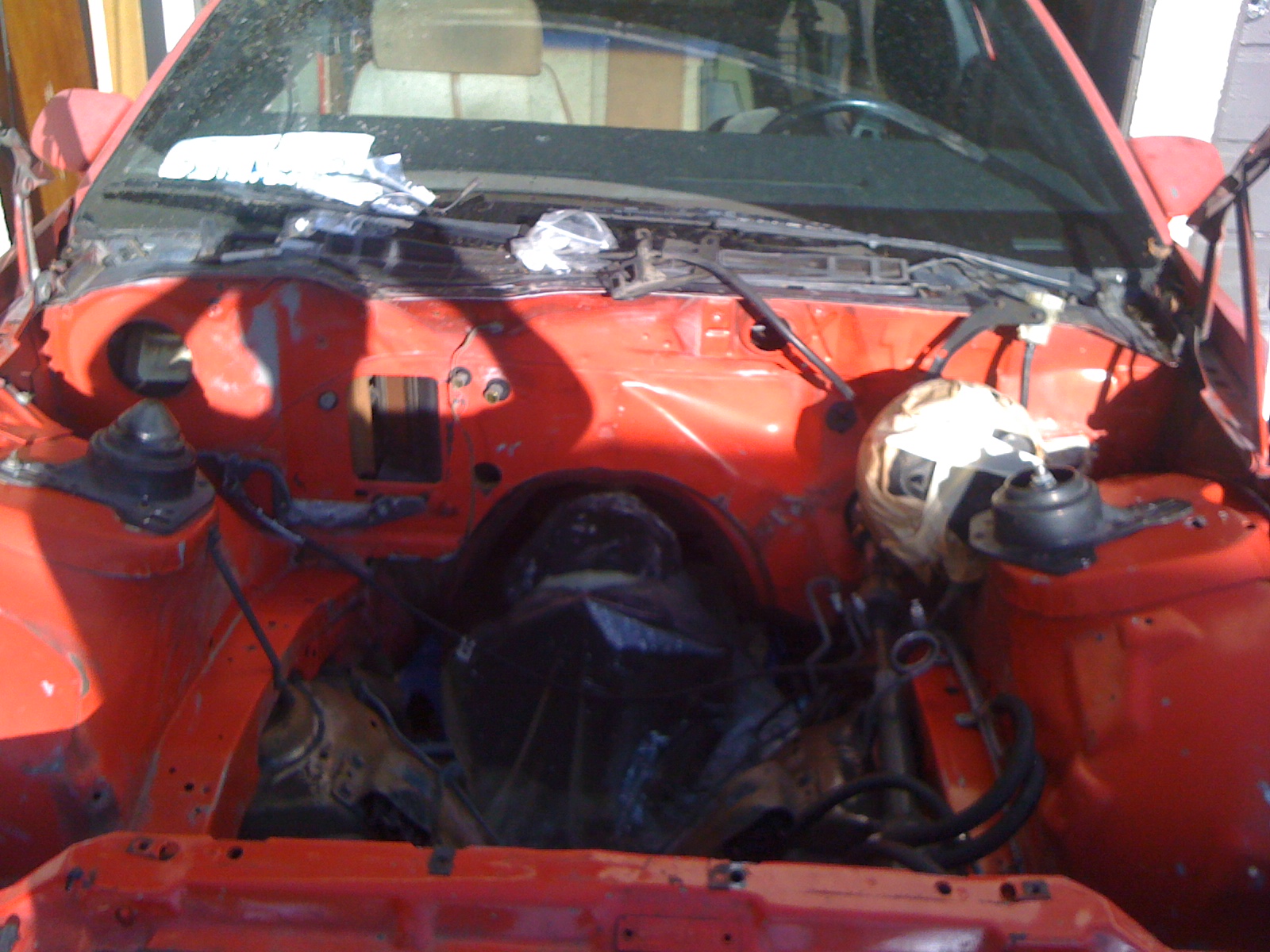

Need help engine bay
Alright fellows, need tips or any advise that you guys can give me to get my ebgine bay cleaned, sanded and sprayed but need to know what else to remove that way or put a side. Here are some pics to get an idea on what I've done already
Attached Thumbnails Need help engine bay-img_0627.jpg   Need help engine bay-img_0628.jpg   Need help engine bay-img_0629.jpg

looks like you've got just about everything out that you can. i don't see anything else really thats removable, cept maybe the k-member?

You can run braided fuel lines from the chassis hardline to the fuel rails.
And you can run braided power steering line from the steering box to the power steering pump.
The fuel line you can just use normal braided fuel line, but the power steering line you must use special high pressure line with crimped ends to prevent leaks. These lines are expensive to make. Here's a pic of the braided fuel lines
In my opinion it looks a hundred times better than having those rubber lines wrapped in coil loom which attacth to ugly steel fuel line then to the fuel rail line.
I can hook you up with the part numbers if you want to run this exact setup, but some guys cut the fuel lines off the fuel rail and modify the fuel rail for the line to come out near the fuel pressure regulator and at the front of the rail.

what about like my brake booster, fuel lines, brake lines strut base is any of that necessary

You can paint your strut towers, or buy new units from KYB, theyre about $50 a piece, and will look great. Paint your booster as well.

p/n's would be gratly appreciated

KYB Strut Mounts: Passenger side KYB-SM5026
Driver side KYB-SM5027
So here's the fuel line part numbers, from the fuel rail to the chassis hard line.
14mm FUEL RAIL>EAR991954>EAR809006>Braided Line>EAR804606>EAR9894DBH>CHASSIS HARD LINE
16mm FUEL RAIL> EAR991955>EAR809006>Braided Line>EAR804606>EAR9894DBJ>CHASSIS HARD LINE

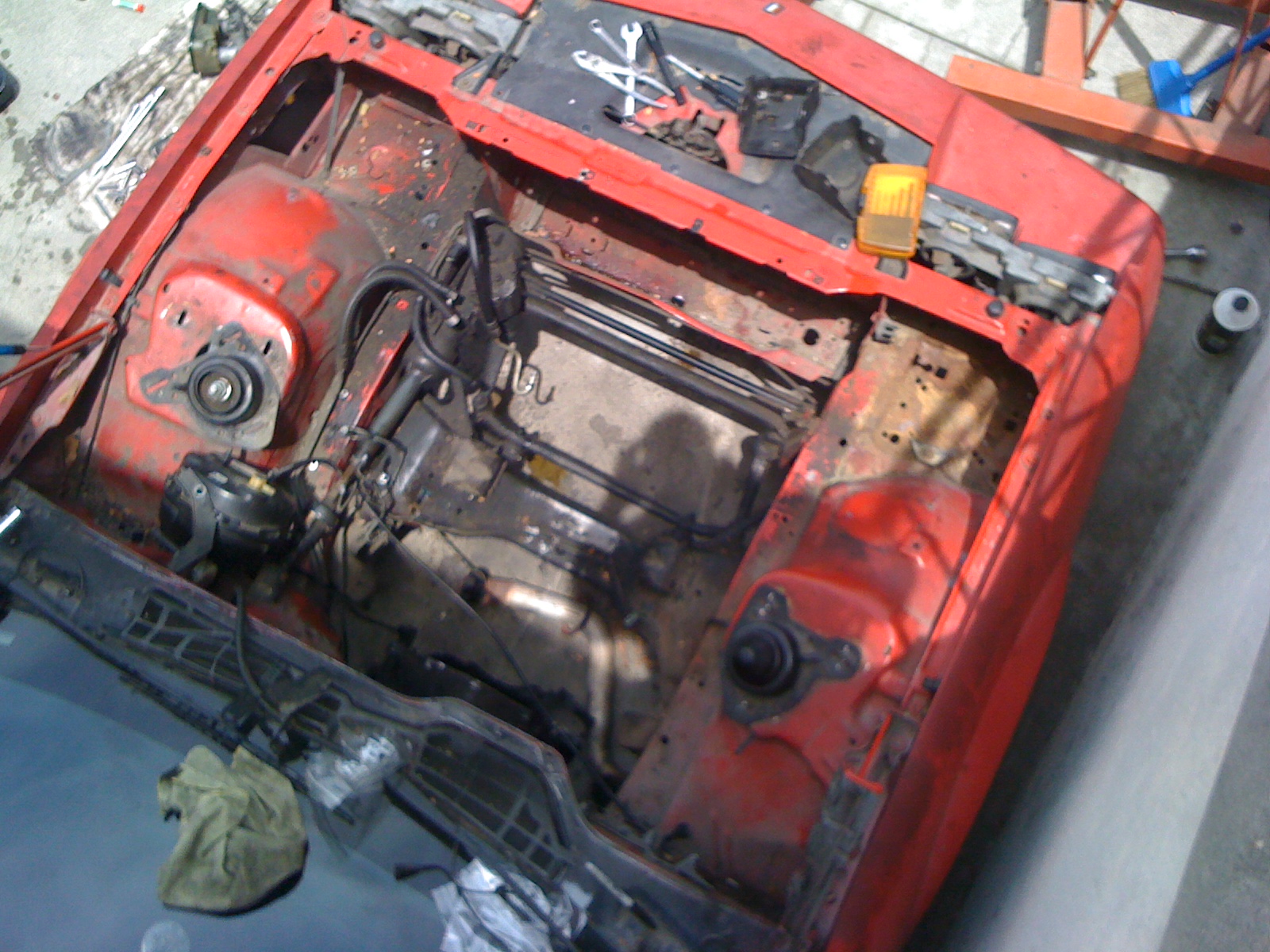

here's another pic

I'd hit up the engine bay with industrial strength degreaser. Get that steering box all cleaned up. Spray her all out with the pressure washer and get that paint looking good.
This bay has a lot of potential.
