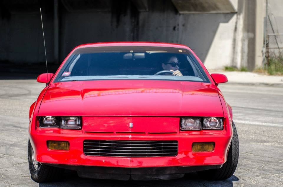

Hello MY87LT,
I need to replace the front bumper to my 91 Camaro RS, but I know that it is not the stock bumper. My dad changed it for me in high school and I think it is from an older Berlinetta. Can you help me verify??
Thank you!

Thank you! The front bumper isn't so nice after this morning's fender bender... That's why I am looking for info to replace it and get it looking nice again!

Yea, that's the nose from the non-ground effect Camaro's from 1985-1987. The nose you need you can get from from a 1985-1992 IROC, Z28, RS, and even the 1988 Base Camaro. It should fit without issue. The ground effects from 1985-1990 are different than that of the 1991-1992 Camaro's.

Thank you for the information! I really appreciate. Now I just have to hunt for one. Do you recommend placing a "wanted" ad in the marketplace section?

You can, or check with local bumper shops in your area if they have any front bumper covers for your Camaro.
