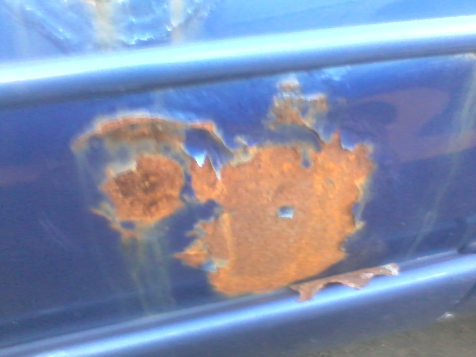

Hi, I am new to the forums, and I have a question. I have a '91 Firebird with some bad rust. I was hoping I could spend some time fixing up the car to run like it did when I got it. I sorta let the car go for a while, as you can see, both mechanically and body-wise. What I was wondering is, looking at the pictures here, does anyone think that this rust is fixable and is this car worth putting a lot of money into mechanically? I would imagine that this rust is worse than just sanding and repainting, but tell me if I am wrong. I just dont want to put a lot into brakes, radiator, and such only to have the body fall apart less than a year later. Also, if it can be fixed half way decently, I dont trust myself to do it, not knowing anything about body work, so in your estimation, how much do you think it would run me to fix? I was hoping some day to get a full paint job, but cant do it now, so just to fix the bad rust, what would I be dealing with cost wise? Thank you for your help.
Attached Thumbnails Body rust-0630102027a.jpg   Body rust-0630102027c.jpg   Body rust-0630102028a.jpg

its pretty rough surface rust, doesnt look like it went through. It can be sanded, the rust neutralized, filled an painted.
What does the underside of the car look like? thats where the rot starts

Well, I was just underneith last night replacing the rear sway bar links, and to me it looked pretty decent. What do you think a body shop would charge, average, to sand/paint?

A good shop would cut the metal and replace it with unrusted metal. As for the cost, it can vary from what they charge for labor.
I would atleast go garb a rust stripper from Autozone/Oreilly near you and grind as much as you can off with it which most likely like the metal as a dimpled surface. Then apply some epoxy primer over it and stop it from getting worse.
i would need better pics, bit it looks like just bad surface rust, not rot, no need to cut it out really. Yes it would be a better job, but it can be fixed without going to that extent

Theres no real way to tell the severity until you start working on it to attempt to clean and see if theres solid metal or if the rust has done its job already. If its at the spots where he showed, its probably already badly damaged under the gfx. You can also see in the rear quarter a small spot starting to bubble the paint.
Hopefully its just surface rust and would grind off easily, I had similar rust and used Autozone # 03172NA to grind all of mine off then used some rust spray or Rust remover I am guessing from my neighbor that he uses at his shop and left that overnight and then put a coat of epoxy primer and body filler to smooth it out.
Like you said, you can't really tell unless you see it for yourself or look at it better.

that doesn't look terrible, but you gotta check underneath the ground effects since if it's exposed like that, it probably means that there's crap under the plastic parts. And just remember, if rust appears there, it might be also in less convenient spots... ie holes in your floor. Jack it up and take a good look, and take off the plastic pieces and get back to us.
