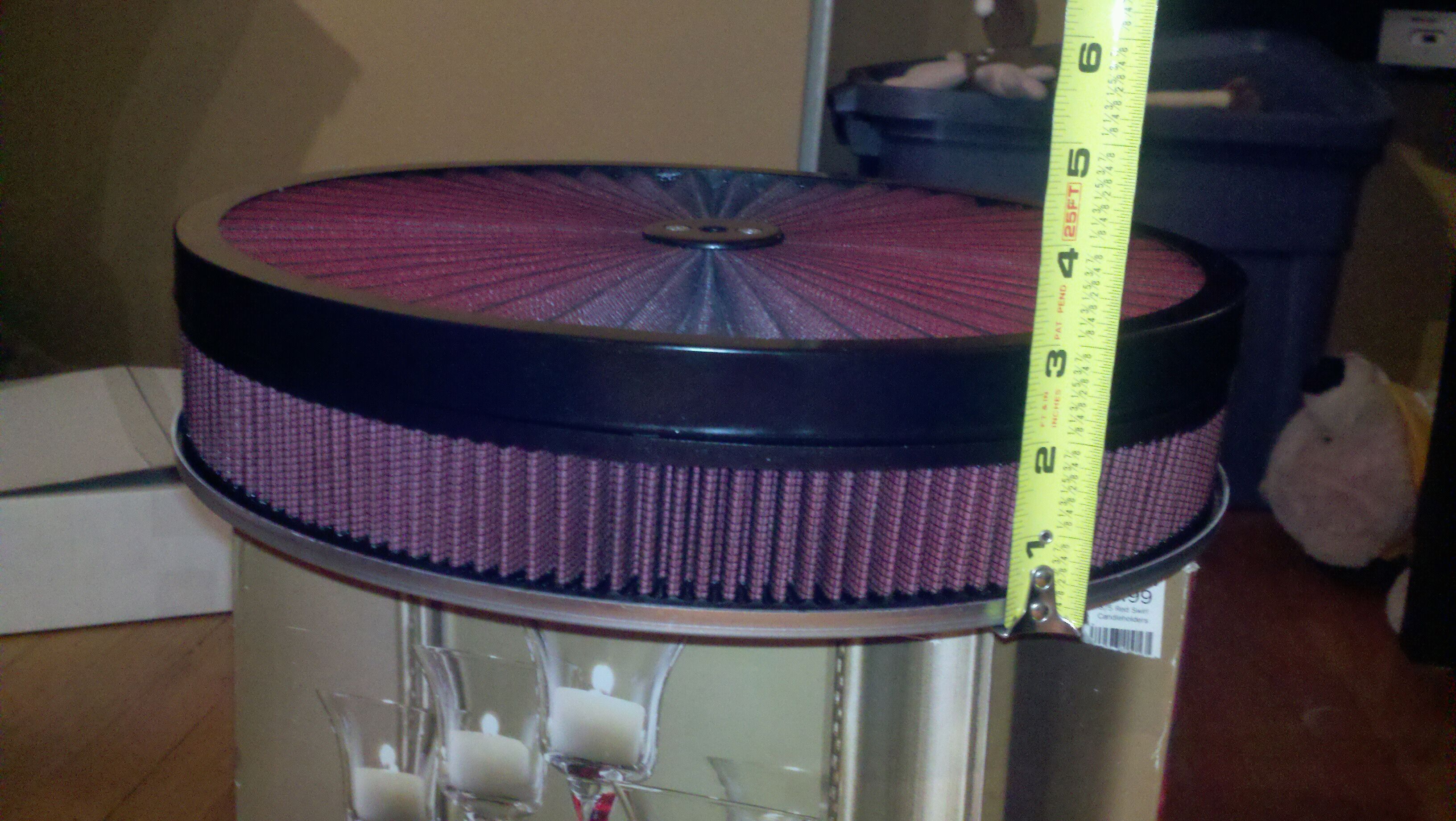

Also just an update... the 2" AFCO air cleaner i recieved is not really a 2" drop air cleaner!! GOD DA@MN IT! its actually less of a drop than the stephs fabrication air cleaner that i was using originally.
I might have found a solution tho, using a 2" filter and the drop air cleaner i was able to get the height that i want, however that is with a 2" round high flow oiled air filter. I also got a high flow filter top to use with it but it the drop air cleaners center (inside) bulge sits higher than the top of the 2" filter, then the carb vent tubes push the filter top about 1" above the 2" filter. So the filtertop is basically useless.
Im worried about the 2" filter not flowing enough for the 521... as i did the calculations and the 521 requires a 3.5" filter minimum. However spectre rates there 9"x2" filter for 600hp and 880CFM http://www.jegs.com/i/Spectre/865/88...oductId=924092

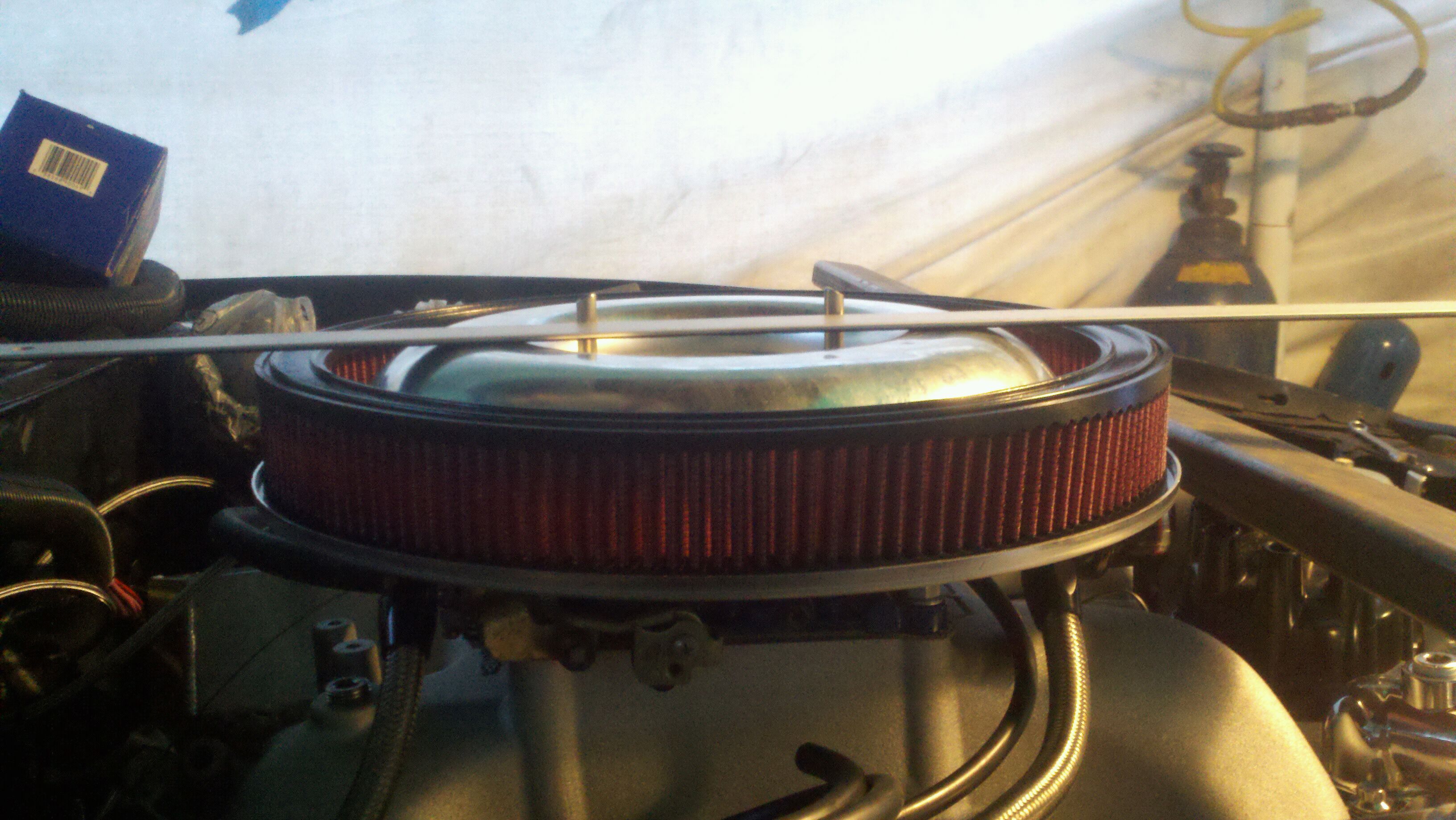

some pics with the afco air cleaner and the 2" filter. It looks small i know... not sure if its going to be enough filter. U can also see the height of the filter and the carb vent tubes where it makes the filter top impossible.
Im hoping that i can cut 1/4" off the base of the air cleaner so i can increase the drop 1/4" more. then see if i can find a cheap red oiled 2.5" filter for some increased filter CFM to feed this beast.
any ideas?
any ideas?

So I finnally found a true 2" drop pun aluminum air cleaner... its from hpr... which is a racing company. Ill post the site in a later post as im on my mobile device now. The air cleaner is much thicker than the stephs and afco air cleaners. But I have a small issue... with the 2" drop the base of the air cleaner contacts the needle screws on the front and rear fuel bowls just enough to make the base rock back and forth and not seat all the way down on the carb. I can either raise the cleaner slightly with this nifty little bullet spacer and seal (pics later) and it will raise the base about 1/4" . Or I could dent the base of the air cleaner to clear the fuel bowl needle screw.
Now with the 2"drop base with a 3" k&n filter the front of the air cleaner is 3" above the fender line and raises up to about 3.75" above the fender line 3" farther back from front of the air cleaner due to the bulge in the top of the cleaner.
