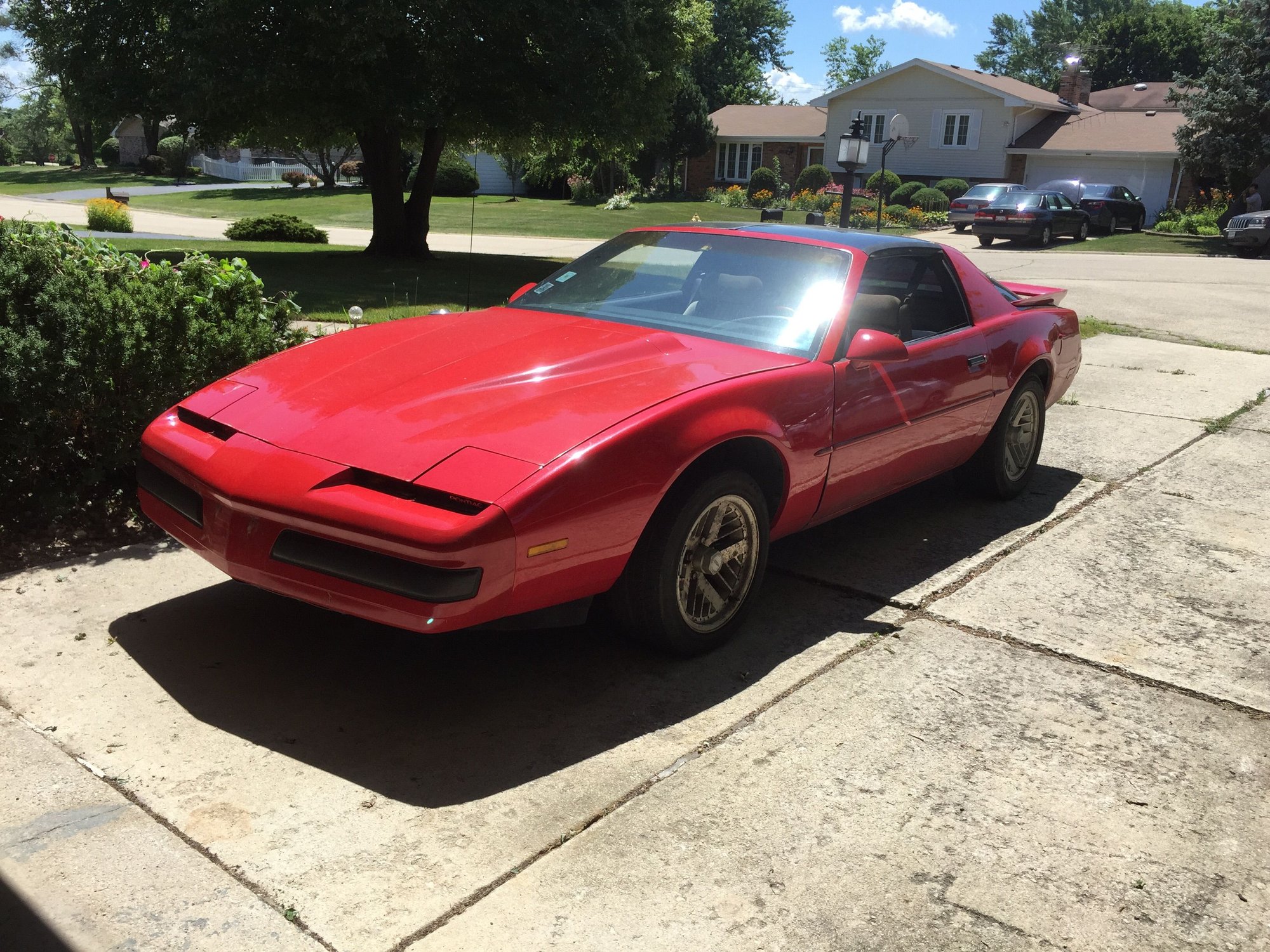

Upon purchase of it. These were the rims.

That looks like a Formula to me. Most likely repainted. Check out https://www.phoenixgraphix.com/ for OEM decals if you're interested.
