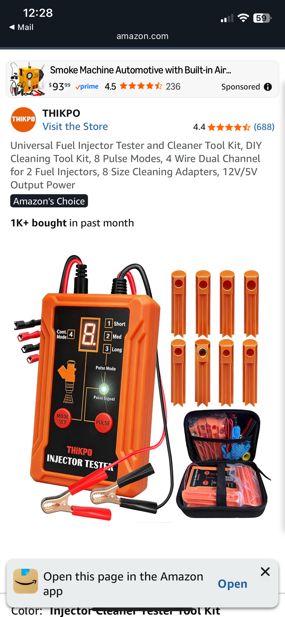

if your tight on funds this would test and clean your 22#hr injectors , Southbayfuelinjectors’s has 22s on their site for a reasonable price.
