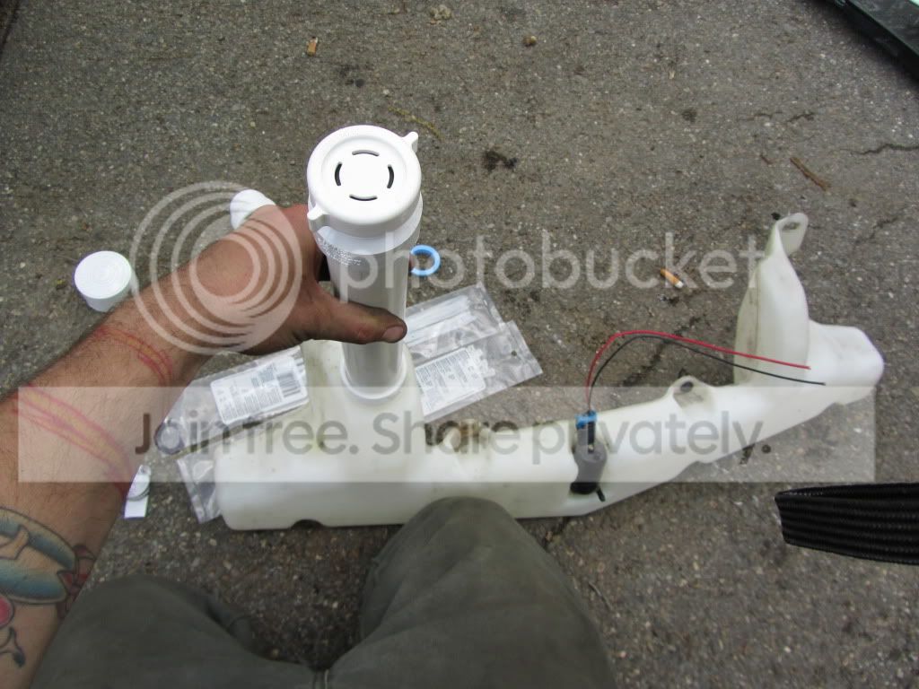

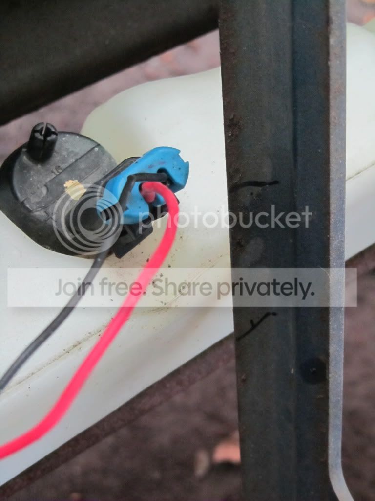

Heres the set-up i put together a couple weekends ago:
Heres how it sits, you need to use small hose clamps on the top mounting holes and secure it to the X rods that are behind the radiator...
This is what i bought from Aubuchon hardware.... about $16
Heres the notch i made in the front nose support, and plastic splash guard removed from either side...
it was hard to judge where to cut the hole in the top sheet metal so i used a couple pieces of clear tape making an X right over the center of the washer bottle, then i slide the panel in under it and marked it
