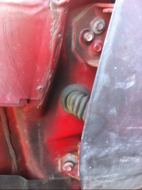

heres the problem.. i dont know if i should try to jack both hinges up it will level out or not tried everything i could think of

Wow, you don't even have the lock on
You could try that. At one point I tried something similar by placing a small piece of 2x4 on my jack and using it to push up on bottom of hinge with my jack. Not sure if it will do much but worth a try. From trying to futz around and get the bolt holes to line up, I found that when the hinge bolts were loose, the rear portion of door could be moved up or down a lot with your hand. Your door doesn't seem too bad height wise but you are getting a weird gap with body.
Here is a crazy thought. Maybe your body sagged in middle due to it being a vert with no subframe connectors. Now after installing good hinge bushings, the doors aren't sagging same as body anymore.

i dunno tried that today.. but wont budge lol.. my 88 trans am the drivers door is the same way.. i guess maybe it will be different when i put wrap around wing on it.. but anyways hears today's results

Looks to me like the back of the door just needs to go down. You can do this easily by sliding the top hinge back a little or the bottom hinge to the front a little. The first will open the gap at the front of the door, the other will open the gap at the rear. A little on each will keep the gaps close to how they are now. Someone has probably used a jack or bar on the rear of the door to pick it up to make up for the worn pins and bushings bending the shell of the door. When you took up that slack with new parts, it picked up the rear of the door. Is the striker still on the car?
