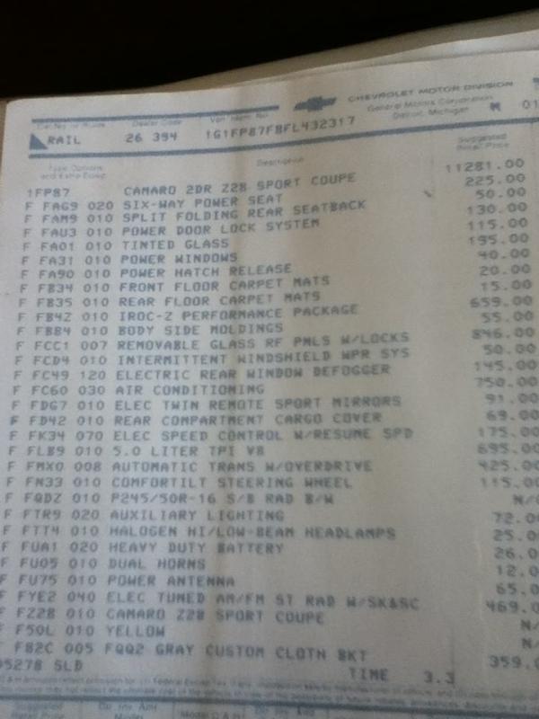

thanks guys..should be interesting..did some digging and found it has the 3;42 rear but is non posi and has g92...I thought g92 meant posi 3;42? I'm confused..it is definately the original rear axle,tube has 8ka stamped into it and no posi tag on the differential cover..That is all I have at the moment,haven't tried jacking it up yet to see if both wheels turn in the same direction or not..
seems like a somewhat rare car..first year model Iroc with all available options other than the rear wiper and overhead console..

G92 means performance rear axle, and the ratios vary. Mines a 3.45 limited slip (Posi). It should be on your SPID sticker in the glovebox.

yeah,maybe thats where I am confusing myself..I just assume that performance rear axle means limited slip(posi)..I just need to get the spid checked and lift the rear off the ground and see what I have I guess..

G80 is limited slip

ya my 85 iroc has the 3.42 one legger also it was a lb9 car thought it would have a posi but nope

Mine was exactly the same way too. 3.42 1-legger LB9.

Very strange how they did that. I have a 2.73 with posi, can barely bark the tires from a dead stop.

thanks guys..yep,exactly what I have..3;42 one wheel wonder and lb9...took 2 days to get it off the trailer this weekend..bought it without even hearing it run..if thats any indication on what I paid for it..lol..bought a new battery and some gas Saturday morning..she wouldn't start..after a few hours of testing with a P.O.S.. volt meter I concluded that the distributor pick up coil and ignition module were both bad..replaced the radio interferance harness while I was in there since the plastic housing just crumbled in my hands..got it all back together Sunday morning..fired right up without skipping a beat..very pleased..drove around the neighborhood and tranny shifts nice and crisp and overdrive is functioning properly..one problem I do have however..the fuel pump is constantly running..turn the ignition on and just keeps going..doesn't shut off after priming..is this normal behavior for an 85?

Welcome back, and nice car!! Love those yellow IROC's. That is a dealer invoice you have there. Take the ship date and go back 1 or 2 days and that's when the car rolled off the line.

right,I remembered that after I first posted..invoice,not window sticker..I pulled the interior out so I could wash the carpet..it is filthy! Will try cleaning before I buy new..the original stuff looks in good shape just needs a serious bath with a pressure washer..lol
