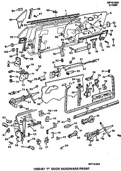

Heres a part diagram and pics.
I have had no luck finding the window stops either new or used.
Used are usually broken anyhoo.......................

Its called a "stop"
