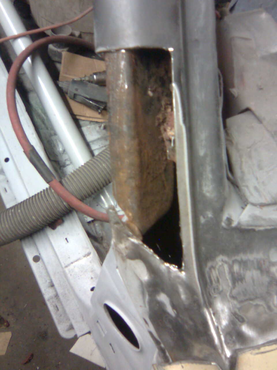

There is foam on the inside of the pillar near (beside) the base of the windshield. It traps moisture against the metal and causes it to rust out here. If you clean it up on top only it will just come right back.
You need to cut it out, remove the foam, make a new patch, weld it in, body filler, prime, paint.... I also sprayed chassis saver all inside the pillar afterwards (with a rigged wand sprayer).
