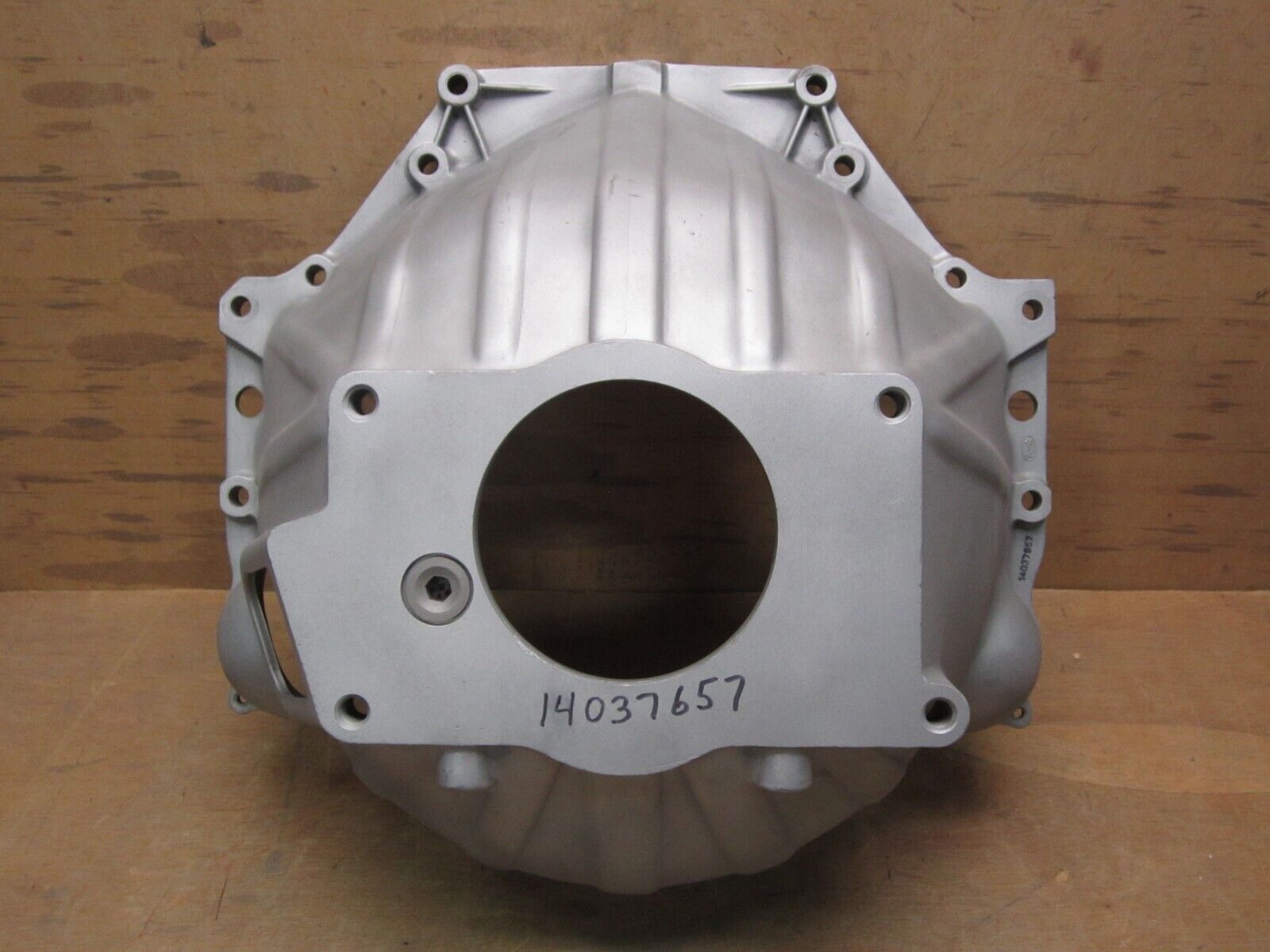

Just finished my 4 speed swap. Converted to hydraulic setup using a Howe throwout bearing. Pretty easy to setup. Used a super t10 and bellhousing from a late 70's camaro. Using a spohn transmission crossmember/torque arm. The driveshaft came from a 82' camaro with a 350 trans. Shifter is a hurst part #3917960. Only issue I had/have is that the shifter stick is too short for the console. The stick could be 3-5" longer. Has anyone corrected this issue with a different stick? Maybe part number #5387991?

Ignoring the clutch linkage issue, or torque arm issue for folks that have hydraulic TOB and alternate torque arm setup, is there any issues sing a 'straight up' bell housing Super T-10 and a off the shelf shifter?
I have a 80-82 corvette shifter, which mounts a little farther back and higher up. I wonder if it would cure the problem of needing a longer shifter stick?

The hydraulic TOB would fix the issue that a "straight up" BH has in these cars; namely, requiring the "dog leg" fork, to get the linkage end of it down below the floor pan. That's a trypical crappy 70s "solution" to a problem that otherwise would have required innovation (which is to say, at the time, "inventing" a hydraulic TOB)
Other than that, I don't see where there would be any problem. If you weren't too concerned about the shifter exactly duplicating the stock one, should work fine.
I'll have to mock one up on the bench next to a T5 I have to get an idea of where the shifter will end up. I googled some photos of how the 82-83 cars did the T10 and I don't quite get the engineering. It uses a "straight up" bell housing but a rotated clutch fork, fine, but then why the goofy shifter that mounts on the right side? Was that to allow room for a torque arm mount?
And if GM engineered a bell housing with the rotated clutch fork opening but straight up pattern for the transmission, why did they rotate the transmission pattern for the T5? A TKO which is larger fits just fine "straight up" so why would they have rotated the whole transmission?
needing a correct bellhousing/shifter linkage setup from a 4 speed car? I’ve collected a couple sets over the years.

The firebird has a LS engine and a lakewood SFI bell housing. If I do use the T10 I'm not sure which shifter I'm going to use. I haven't really mocked anything up yet so I'm not sure where the thirdgen style T10 shifter ends up vs a typical T10 shifter.
