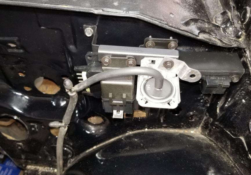

Spent some time cleaning up the under hood controls. These are the spark controller module, electric fan controller relay, fast idle relay and manifold differential sensor. They all seem to be working but i have not way to test until I start the car.. which will be awhile
Before cleaning
After cleaning and reinstalled

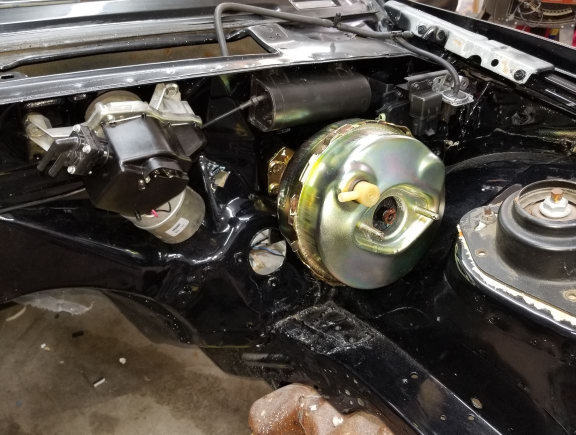

I have completed the pedal assembly and mounted the brake booster. I had the booster restored back in 2007. It has been sitting in a box since then and I was a little concerned about seals drying out or it not working but it seems to be fine. Guess I’ll know when I get to the point where I can start the car.
I don’t care for the new clutch pedal pads. It just doesn’t look right. I ordered a 1981 Firebird clutch pad which looks more original but I have no idea if it will fit. I’ll know in a few days when it arrives
I also worked on the wiper motor. My car did not come with pulse wiper originally. Fortunately the wiring is there already. I just had to source the motor, pump and a few other parts.

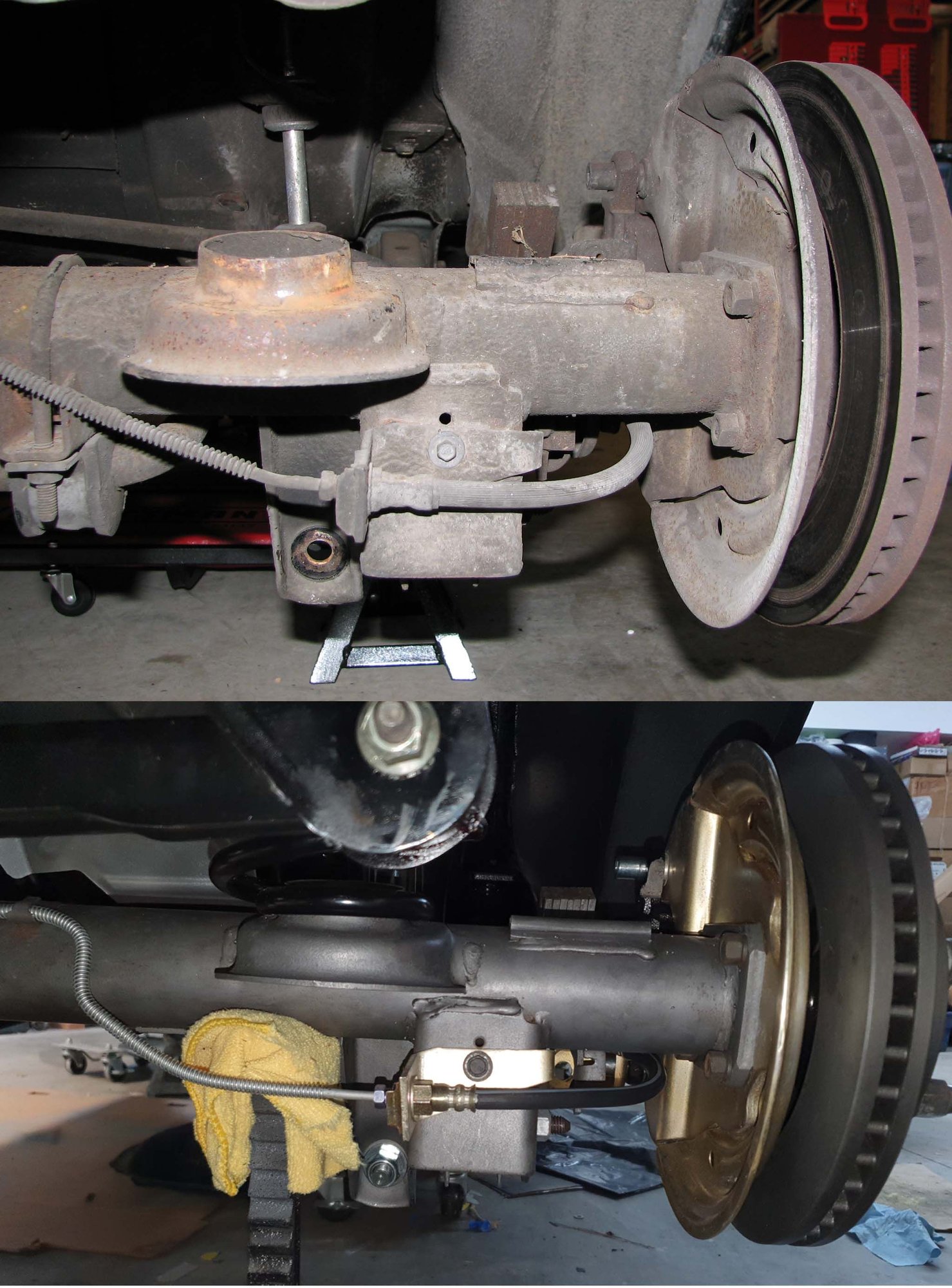

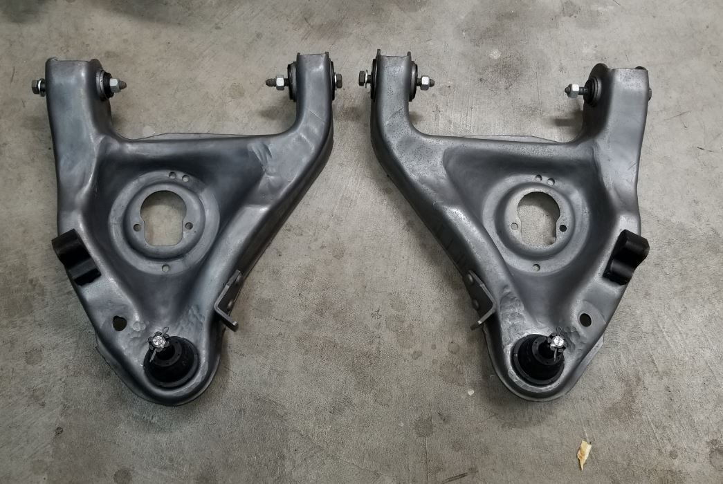

More progress is being made. But its slow going. The suspension has been removed and I’’ve been working on rebuilding is various parts. It took a lot longer than I expected to clean up the front cross member. It was in good shape excpt for the rust and dirt, but I don’t have anything big enough to soak it in. I started with spray on rust dissolver gel but the part is too big and I couldn’t control the gel. It would run or dry to soon because the area was to big. I ended up using Evapo-Rust and a large tub to soak sections a time. It cleaned up nice. I mounted the motor mounts and front brake lines. I’m leaving it natural for the factory look but I did coat it with Rust Prevention Magic.
The front spindles and rear control arms are cleaned up and ready to be installed. Finding the right hardware has been a little challenging. i was able to reuse the bolts but i am replacing the nuts and washers with new OEM parts.
Front brake calipers have been cleaned up and rebuild with new hardware. The rear calipers have also been rebuild too with new hardware. It was challenging to find a rebuild kit for the rear calipers. The GM rebuild kit has been long discontinued but i did find one aftermarket kit from O'Reilly's. No other parts store had any that i could find.
Front A-Arms are also ready to go. New bushings and hardware. I bought new GM ball joints back in 07 but when i took them out to install them they had minor corrosion and the grease had dyed out. I'm not sure if they are good or not. I assume they can be loaded up with new grease and would work just fine. the other issue i had with them is they don't look the same as the old ones. I wanted something aesthetically close to original as i can get. I found Moog ball joints look almost the same so i ended up buying new moog ball joints.
I'm not ready to install the parts yet. I need to get the undercarriage cleaned and a few spots painted. it will probably be a few months be the suspension is ready to be put back together.

The rearend is back in the car. I also took this opportunity to swap out the open diff to a posi.
The internet be all like, “it’s easy to swap the diff and install a posi”. HA. Once I started researching what I needed to do it became clear there is an art to setting up the rearend. I reused the pinion and rear, so I didn’t have to mess with the pinion depth. I did have to buy a few tools to measure backlash and preload. Getting the proper carrier shim setup was a pain.
It took a month to clean up and rebuild the rear axle. Then another month to get everything ready to install it.
This car also has rear disc brake which is a less common option. They have an integrated parking brake and I couldn’t figure out how to orientate parking brake lever but turns out it didn’t matter. Once the calipers were installed they self-adjust with a few pulls of the lever.
Here is a before and after of the rear axle. The before was taken in 2007 as I was disassembling the car. The after was taken just after I installed the axle.

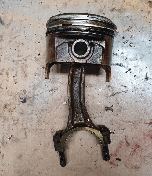

Yeap, this happened.
I’m in the process of inspecting the engine and cylinder #7 had a bent rod. The weird part is the rest of the engine looks great. There is normal were for 70K, the camshaft and crankshaft look good. The pistons look good and the cylinder walls are smooth. No scratching, no rust or other problems. There is even still crosshatching visible. The cylinder heads look good too. Even cylinder #7 looks good. When I dropped the oil pan it was “clean”. The oil was black, no water or sparkles, no sludge. Just dirty black oil.
When I bought the car I only drove it for maybe 30-40 miles then started taking it apart. It ran a little rough, but it was like old car rough not mechanically broken rough. I remember it pulled strong and was a hoot to drive.
Looking online it seem the most common causes for bent rod is hydro lock or over revving the engine. I don’t see any evidence of water in the block. It is a manual so I’m guessing it was over revved at some point.
Old Jan 31, 2024 | 09:48 PM

With major carb issues on a sbc, the fuel tends to pool in #7. I'm betting on hydrolock from fuel.

Sorry to see that.
Looks like a home made attempt at variable compression ratio.

Happened to a friends tpi car that he bought from another friend. Turns out the firing order was wrong on 4 cyls. 5-7 were swapped and can't remember the other 2.
Tore into it because of a weird knock, turns out the rod was bent just enough for the counterweight to hit the bottom of the piston skirt. New rod and it was good to go.
The machine shop said the same. Most likely hydrolock

Looks amazing! What product did use use to remove rust and is that bare metal finish or painted?

They are bare metal. That's the correct finish for this axle. I used used Evapo-Rust to clean the parts then used rust prevention magic to keep it from rusting again.
