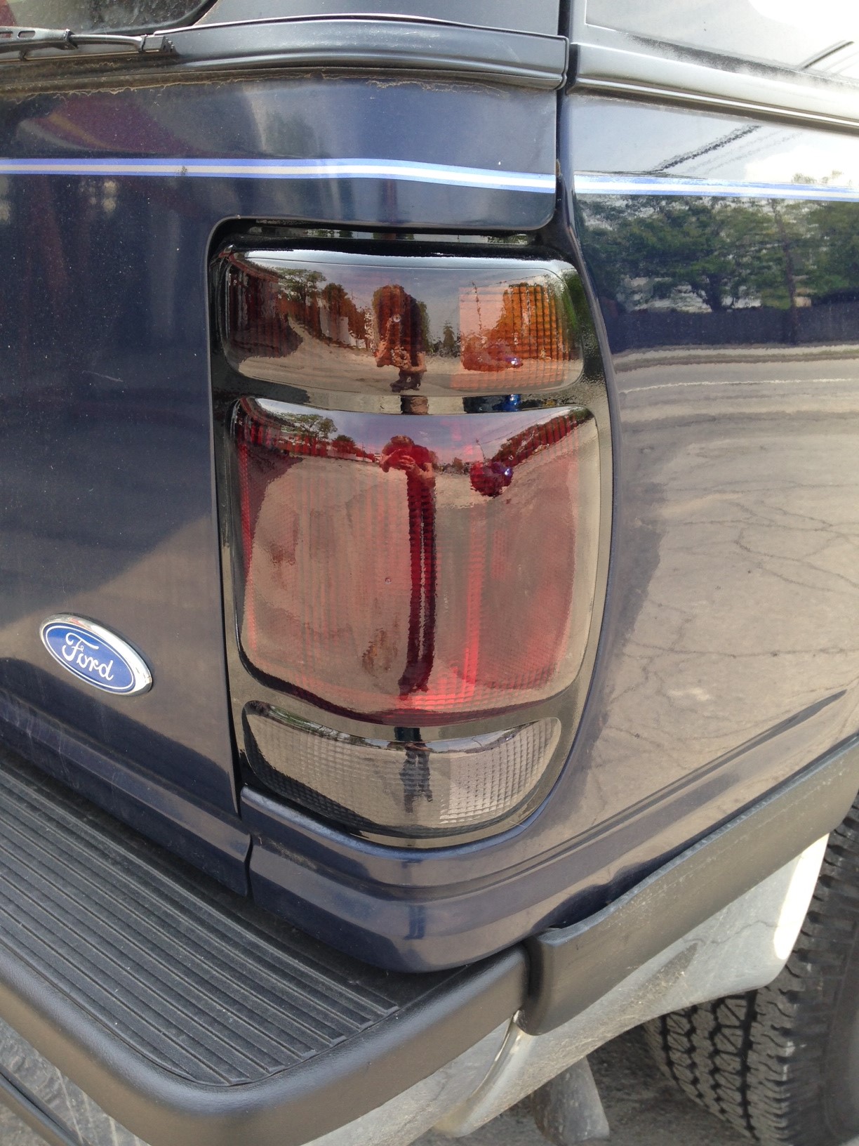

Eastwood and SprayMax sell an aerosol 2k clear, about $20-$30 a can. I've used both and they're very easy to use, and the finish is absolutely dynamite. Worth the money for sure.
Sprayed the lights on my truck with it after tinting them. This is without any wet-sanding.

This one here?
http://www.eastwood.com/2k-aero-spray-matte-clear.html
or this one?
http://www.eastwood.com/eastwood-s-2...oss-clear.html

Wow,that looks great.

I used the high gloss clear

They only have a 48-hour shelf life once you activate them though, so line up a bunch of crap you wanna spray so you don't waste any.
Also, I'd go ahead and scuff the lights with 2000-2500 grit paper, just so the clear has a little more to bite into.

I had the same issue I wound up using heavy grit plastic polish followed by fine grit and then some kleenmaste plastic and glass brillianizer. Worked great
