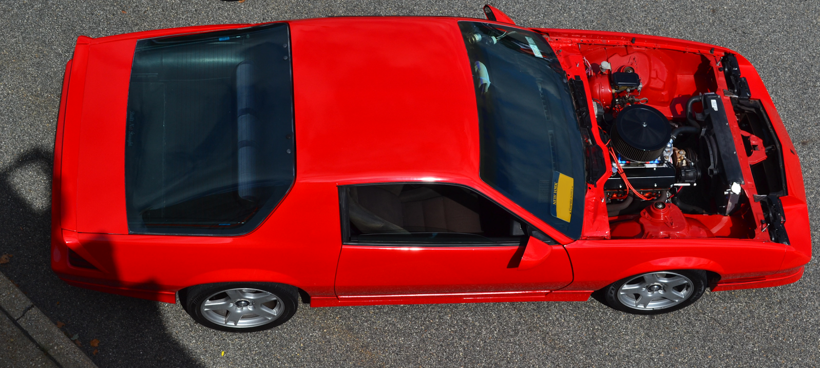

Originally Posted by blackbmagic
You have a window. Your flash time, dust free time ect if you pass that window for clear the bond will never be as strong as it could have been. Sure scuffing it up to allow the paint to grip/bite helps but not as good as a chemical bond.
I have sprayed both summits bc/cc system and single stage. Ill tell you right now the single stage looks killer but is a pita to keep up with. The chemical resistance sucks and its soft. It picks up particles, fallout, contaminants ect. and it is aggravating going over it with the clay and buffer if you don't keep it waxed thoroughly.
bc/cc is great. I have shot the high solids clear and its tough as nails. It dries thin though so put on a few coats. One light base two medium mid coats and 2-3 heavy final coats.
Engine bay was shot with single stage and no clear. Body was shot with bc/cc
THats a clean camaro!
Thanks, I did not do much to the doors but degrease them and I know I waited to long for the flash time as I was unsure what the finish would look like with the single stage. The high solids clear I did 3 coats, one light and 2 heavy… and even if I can't wet sand and get it mirror quality (too much **** blowing around into the paint) then I know it will at least be a strong finish. The heavy solid clear seems very TOUGH!!
Anyone know what the flash time is from the single stage to a coat or 2 of clear? Im currently only using (and only have) the fast activator (good for like 60*F-70*F) but can be used in warmer temps but you can't shoot a whole car with it as it cures to fast. So Im going to be doing small pieces at a time. So I did the doors and door GFX and fender vents. Next I will be doing the fenders. Then perhaps front bumper and hood and rear wing. Then I will piece it together. I know in 60-70*F temps it was still tacking a few hours out after shooting it… so I know I have at least that long for a chemical bond. I know I want the metallic single stage to setup good and just be tacky before shooting the clear.
